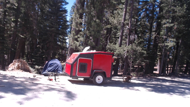

the reasons they leak is they take out a lot of structural support which lets your roof flex more. Think about port holes

saywhatthat wrote:the reasons they leak is they take out a lot of structural support which lets your roof flex more. Think about port holes
Stereovision.
