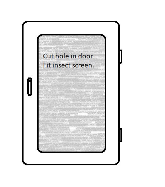

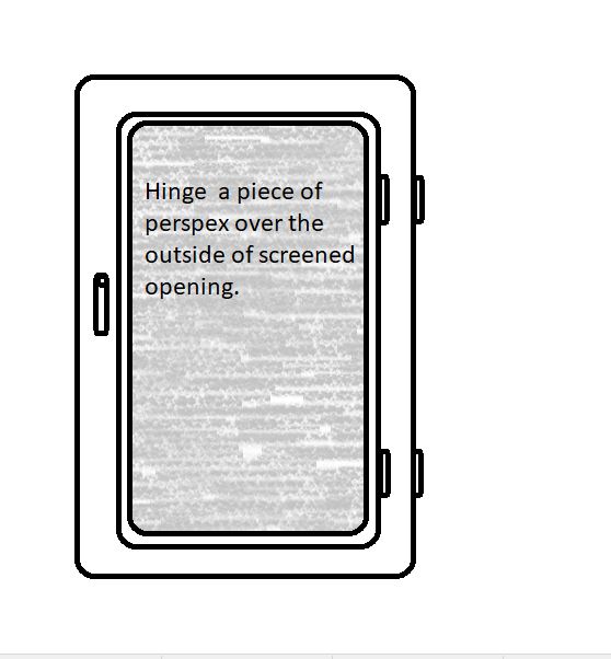

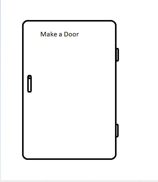

Postby MickinOz » Thu Jul 22, 2021 10:28 am
Shudder to think what an Aussie Traveller door would cost in Aotearoa.
Nearly had to sell one of the children to fund them here in Oz.
I reckon edge is on the right track.
Wiley window with a screen wouldn't cost too much, I reckon.
I would just screen the outside so the window wouldn't need an extra drop in piece.
Or replicate the principle of the Aussie Traveller door.
Make your main door, cut a big hole in it and screen the hole. Then just hinge a solid panel of ply or perspex over the outside.
Job done.

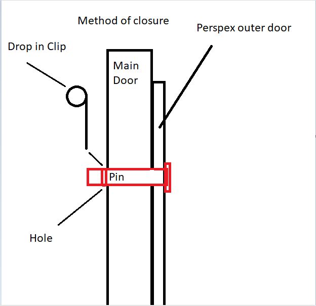

Postby MickinOz » Thu Jul 22, 2021 11:10 am
Closure would be similar to the Aussie Traveller door.
Pin protruding from outer leaf goes into hole in inner door, and gets captured by a clip of some sort,
Being home made, simplest would be if pin goes right through main door and is clipped on inside.
For example:
