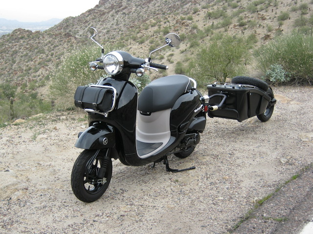

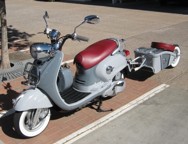

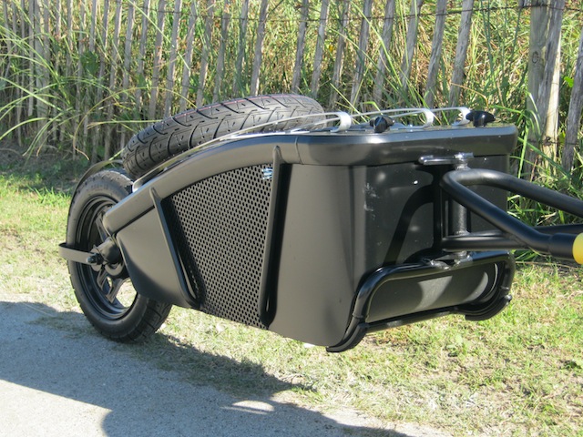

My name is Tom and I have an odd hobby of designing and building scooter cargo trailers. I've built several for my scooters and have been all over Arizona camping with them. The cargo trailers are small...just big enough to pack a tent and some food. A few years ago I built a small cargo trailer for my 50cc Honda Ruckus scooter and rode almost 8,000 miles across the US and Mexico. Solo. It was the adventure of a lifetime.

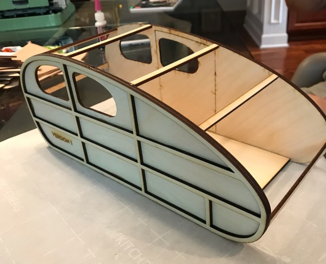

For more than a decade I've wanted to build an actual scooter teardrop trailer that I can sleep in and cook with. A couple weeks ago I pulled the trigger and started the design process. The teardrop will be modeled after the 1947 Cabin Car. I found a bunch of pics online and was able to create cut files from the photographs. Afterwards I built a 12" model out of luan as a proof of concept. Pics are below. The rough size of the teardrop will be 7'L x 3.4'W x 2.5'(ish)H.

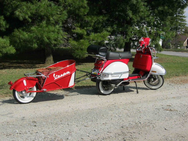

I will be pulling the trailer with my 1962 Vespa VBB, 150cc 2-stroke with a 4-speed manual transmission. Pics below.
The trailer has to be featherweight (literally)...so hoping to do the frame out of aluminum or small diameter steel square stock and the body out of 1" thick foam and poor man's fiberglass. Pretty excited to find this group as I'm sure I'll have lots of questions.

Cool designs. I was wondering if someone could travel with a scooter. I have my answer now. Shame someone decided to steal a vintage scooter we had on our property many years ago. Do you stick to specific trails or highways?

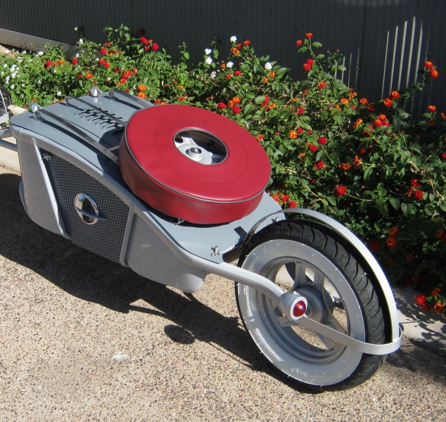

Neat! Will the teardrop have a single wheel like your cargo trailers?

This is my first trailer build that is *not* a single wheel design. I've never piloted a 2 wheel trailer on a scooter before so it should be interesting...lol...

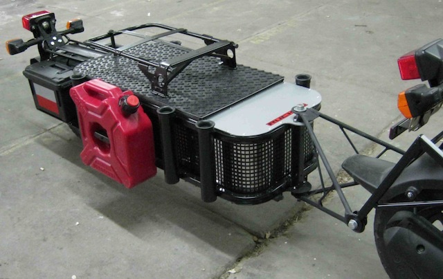

The Idaho Bed Roll is a brilliant product! I spoke to the owner of that company a few years back. I really hope he can get these into production. I do not think a scooter could tow one though. My scoots are 50cc, 125cc, and 150cc. My heaviest cargo trailer is about 125lbs fully loaded and the 50cc really struggles. The other two do ok...but ~125lbs is the max I'd ever attempt. It takes an eternity to get up to 50mph and even a slight hill kills off acceleration pretty quickly. I'm assuming by the Idaho's sturdy construction that it exceeds 125lbs.

I like your designs, very classy. Your goal seems reachable if you can keep it light enough. I would suggest strongly considering the "pico lite" construction and design process. Having pulled several trailers with motorcycles I have found aerodynamics to be super critical, and 150cc is a limiting factor. So my suggestion is to consider an expanding teardrop shape to keep the frontal area to a minimum while towing.
