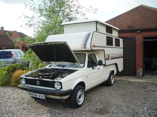

The only vehicles that I can think of with a bed of roughly the same tiny size are the VW Caddy (first gen, and longer bed) and VW Beetle conversion pickups.
Coincidentally, the Caddy is also unibody and FWD.
The biggest problem you'll run into, I think, is the combination of FWD and the tiny bed requiring cantilevering the camper *way* off the rear end of the vehicle. If the camper is heavy, traction and handling may be impacted.
I can't find any DIY designs on these.
But there were commercial offerings.
https://nl.m.wikipedia.org/wiki/Bestand:Vw_caddy_1_a_sst.jpg
