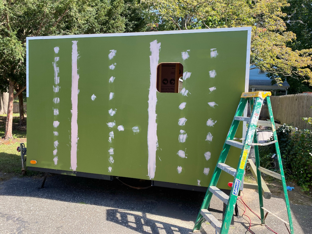

Hello all,
So...I went the cheaper route when skinning my camper and I am paying the price. I am watching the painted wood surface deteriorate as we get hit hard with rain all day and night today. I used porch/patio paint over plywood and it's holding up nicely on all areas where the paint is directly attached to the wood. However, I made the mistake of using bondo on all of the recessed screw heads as the paint is bubbling away aggressively in just this particular day of rain.
To remedy this mistake, I am wondering if there is a special primer I can put on the bondo to repaint over if I sand off the paint on the bondo areas. Any thoughts?
One Idea I had was to sand down all of the the walls completely. Then spray paint some primer on the bondo, and paint the walls with bed liner paint this time around.
Any thoughts or recommendations? I wish I could afford aluminum sheets but it's too expensive for me (around $1K in just the sheets for a 13'x6.5' camper). PMF would have been best in hind sight but I think it's too late for that.
I was even thinking about using thin .06" 4x8 sheets of FRP from Home Depot and gluing it over the surface but I think that will break down fast by the UV rays if I've researched that properly.
I attached some photos to show the camper if it's helpful. It's still raining too hard this evening to photograph the bubbling that has occurred as of today. I'll take some shots once things clear up.
I look forward to any advice from you experienced owners.

Re: Help! Bondo is bubbling my painted walls
Postby MickinOz » Wed Oct 27, 2021 2:03 am
Bondo is polyester automotive body filler, isn't it? Over here we'd call it bog.
If it is, then you'd have to think an automotive grey primer in a rattle can would stick to sanded Bondo?
