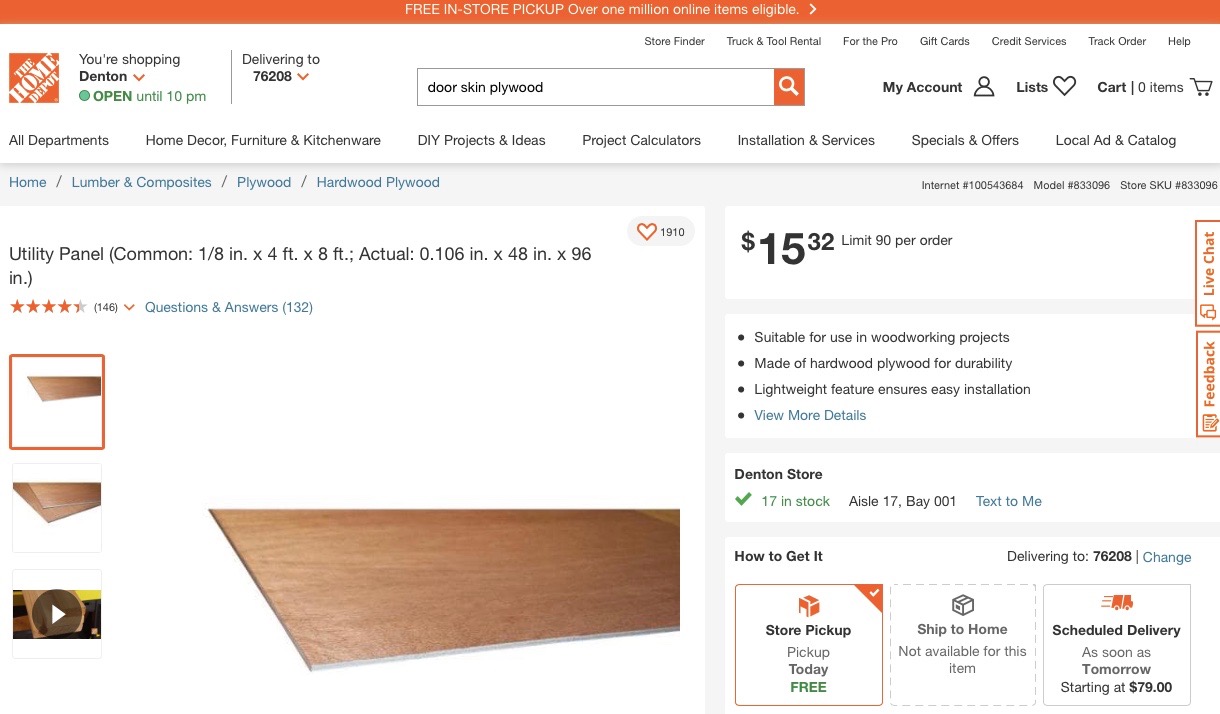

i keep several sheets of this stuff around most all the time
used for making patterns n templates
great for INTERIOR(never gets wet)
Screen Shot 2022-01-04 at 7.43.34 AM.jpg (148.08 KiB) Viewed 1317 times
one side is always smooth and clear
finishes out natural beautifully
paints out very well/smooth
very flexible
the only issue i can imagine would be if you sand the veneer very much you'll sand thru it
sw
