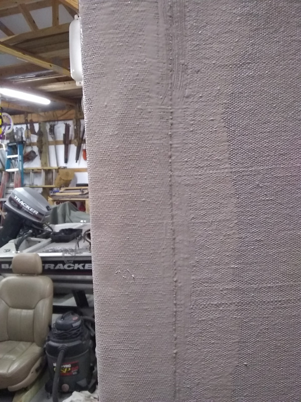

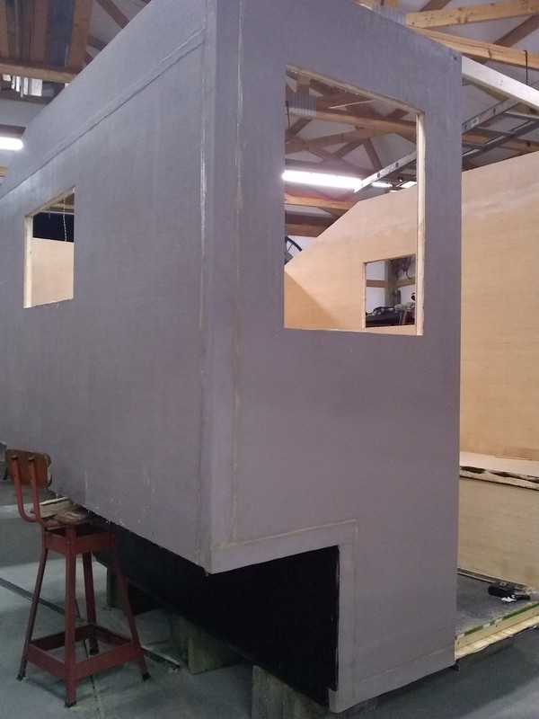

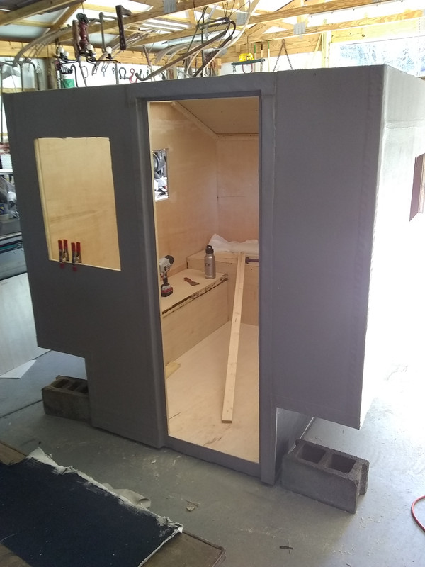

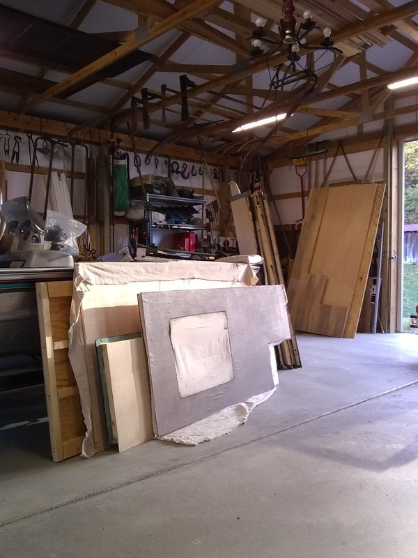

I'm going to fast forward through parts of this so as to not bore you with all of the details. The basic concept is outlined in the other thread. 2x2 framing in the "tub" part with 3/8" ply skin, covered in PMF. The upper panels were 3/8 ply over furring strips. All panels covered with Lauan on the inside and painted white with exterior latex. The panels were built separately due to space constraints and assembled off-site at a buddy's large metal building in the middle of winter. Corner joints were created with a separate piece of square stock and screws driven in at 90 degree angles.
Seams were then covered with painted canvas tape, secured with PL Premium. This worked better than I ever could have imagined, and not one piece of the tape has shown any signs of peeling or coming off. I've done another coat of paint since then and everything is holding up great.

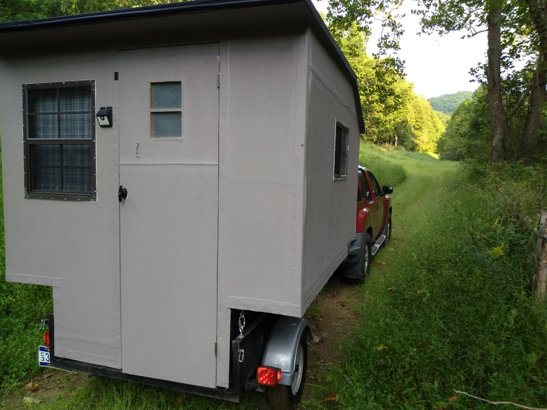

Windows are shed windows and are surprisingly not-drafty even in the winter. The door I made myself and recessed into the side of the camper. It is covered with PMF as well and locks from the inside and out. I deliberately cut away the threshold so it would not hold water and covered the exposed wood with more PMF.
The bottom is also PMF and sits 3/4" off of the trailer bed on treated runners. This design allows air to flow under and water to drain away.

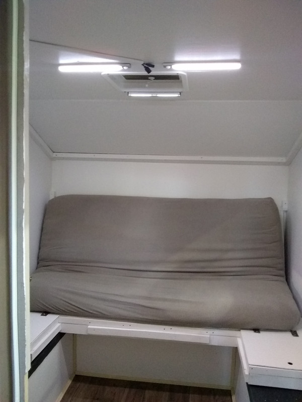

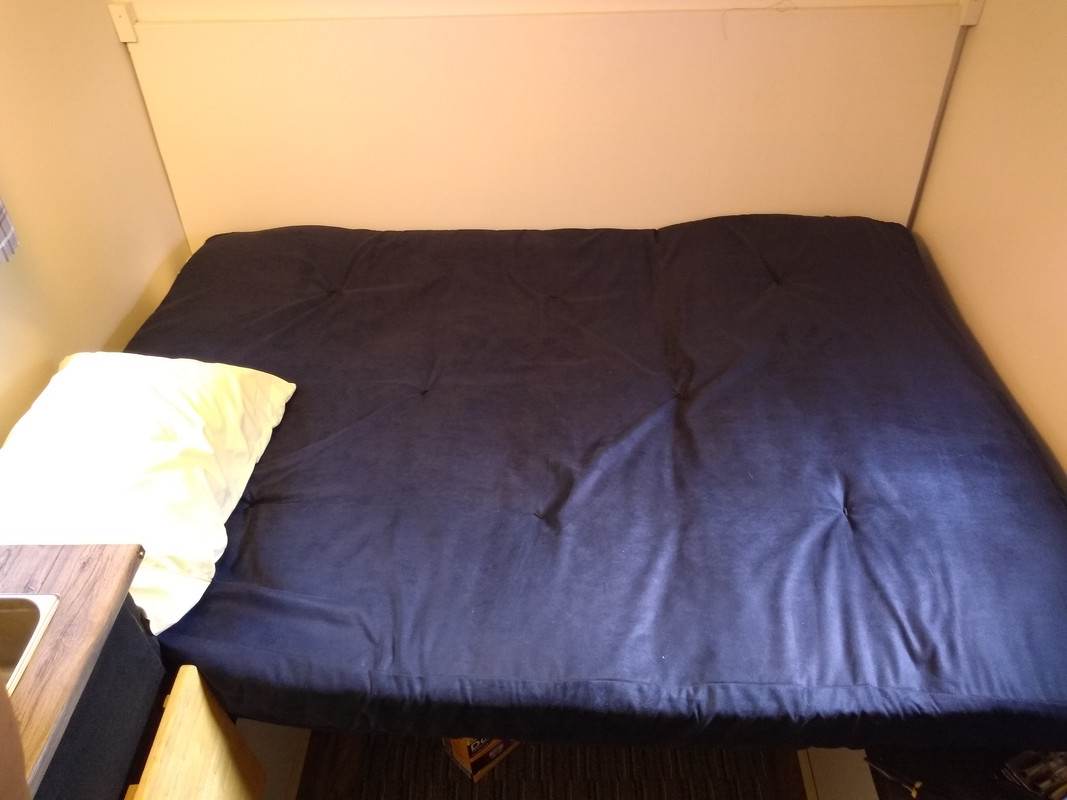

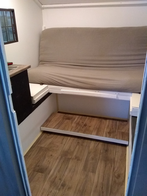

Fast forward...inside is a double-sized futon mattress on a flat platform. Fold the mattress forward, pull the strap out at the bottom of the back, and the panel angles out and stops against two blocks. That's the couch back. When it's folded up straight, the panel engages the hooks on the wall so it doesn't fall over and smash your head. The middle panel drops to the floor as a step for Short Americans (my wife) so her feet touch the floor as she sits. This was the simplest way I could do it, and since the couch back and step are both a frame covered in Lauan, it's also fairly light weight.
This is a pic in the "couch" position before I got a new futon mattress that wasn't rock hard...

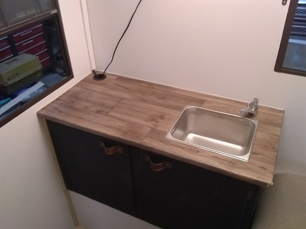

On either side of the gap where the panel was is a storage compartment. I used leather for hinges because that's what I had and it was cheap. It works great. I also used leather strapping for the cabinet door handles because that feels a lot better when you bang against them in tight quarters than something made of metal.

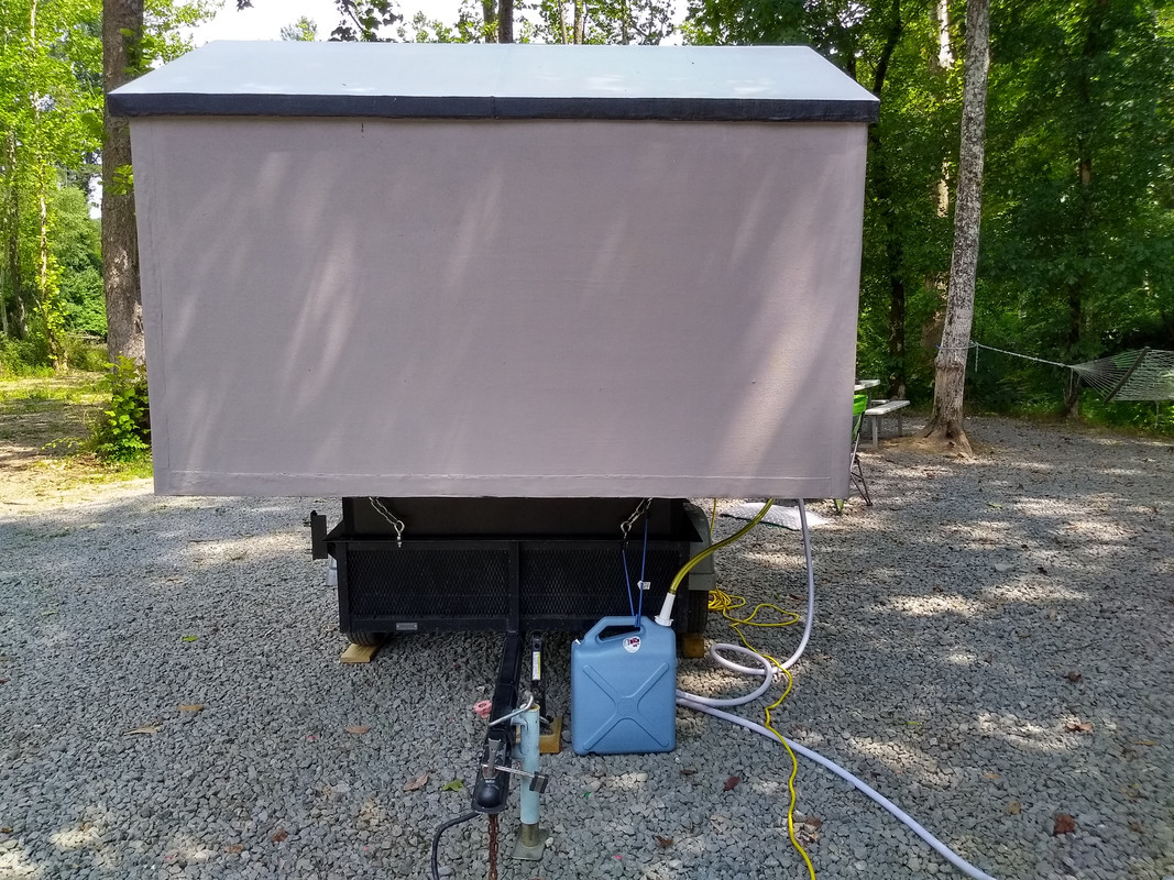

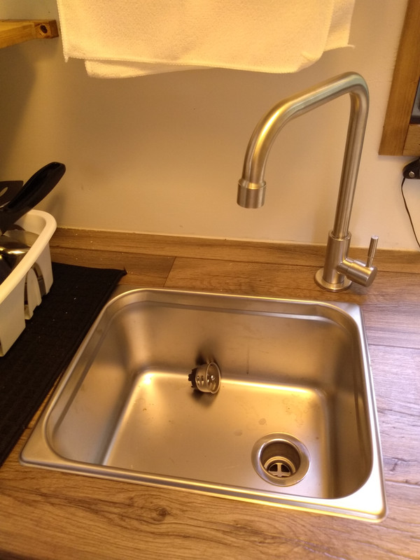

Speaking of cabinets, it's covered with painted canvas just because it looks cool. The top is covered in the same vinyl as the floor, glued, rolled under the edges and stapled into place. The sink is a buffet pan with a hole cut in the bottom for a drain. This is substantially less expensive than a dedicated RV sink. The faucet hooks up to city water, and it worked but was wholly inadequate for washing dishes so I upgraded with a gooseneck faucet I got off of Amazon.
That works 100% better. The sink drains to the outside and if at a campground with sewage, I can run my drain straight into it, or I have a 5 gal jerry can that I use for that purpose.

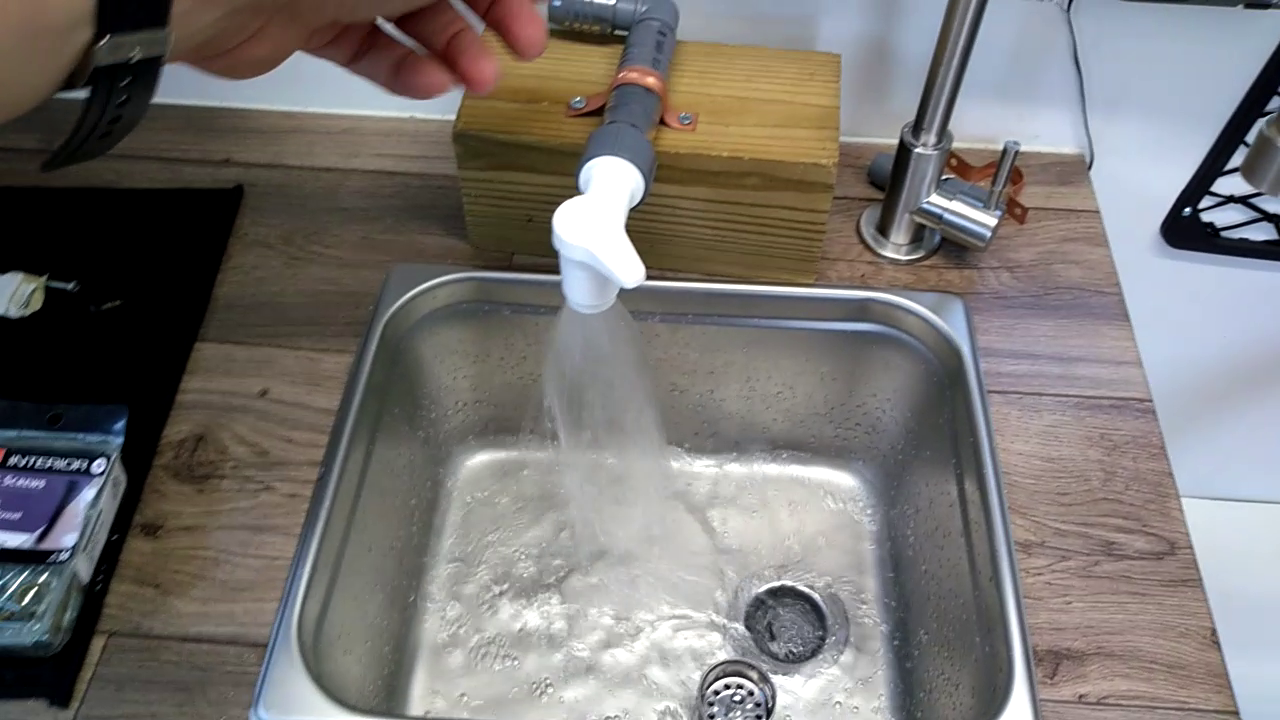

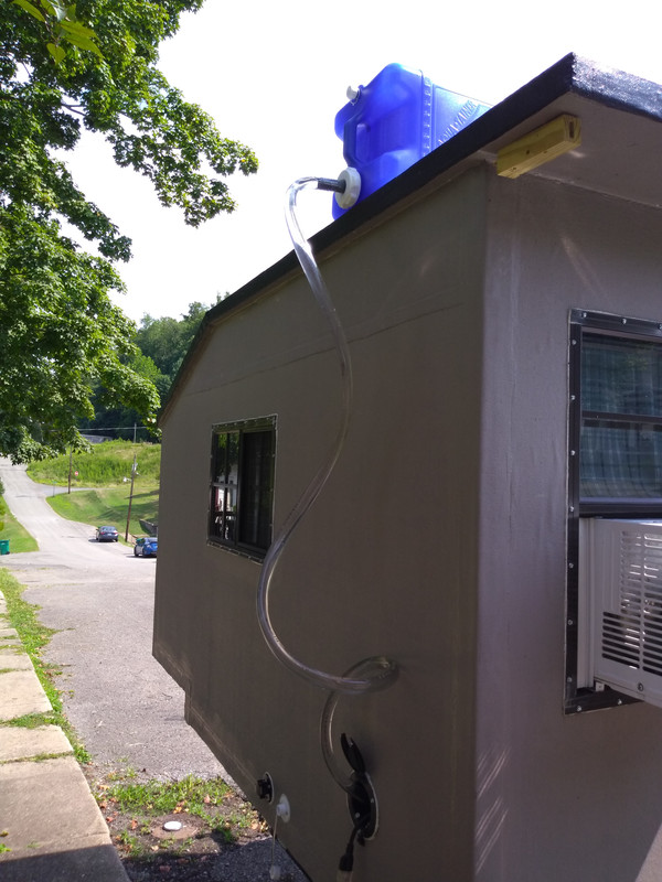

I also have an "alternate faucet" for boondocking that I can hook to my 6 gallon Reliance water tank.
It's a gravity feed system which delivers a very nice volume of water at low pressure. This means I can press fit the connectors into the vinyl hoses temporarily without worrying too much about leaks. The threading of the larger barbed fittings just happens to match that of the little faucet on the Reliance container. Meaning, I can bring that faucet inside and mount it "temporarily" to a wooden block to hold it in place, put the Reliance tank on the roof and hook up all the hoses and just use it with my sink as I always do.
Slick as a whistle and completely removable. If I know I'll be camping where there's a water hookup, the gravity fed system stays home. Plus, I don't worry too much about leaks because there's only one joint inside the camper. It's worked great every time I've used it.

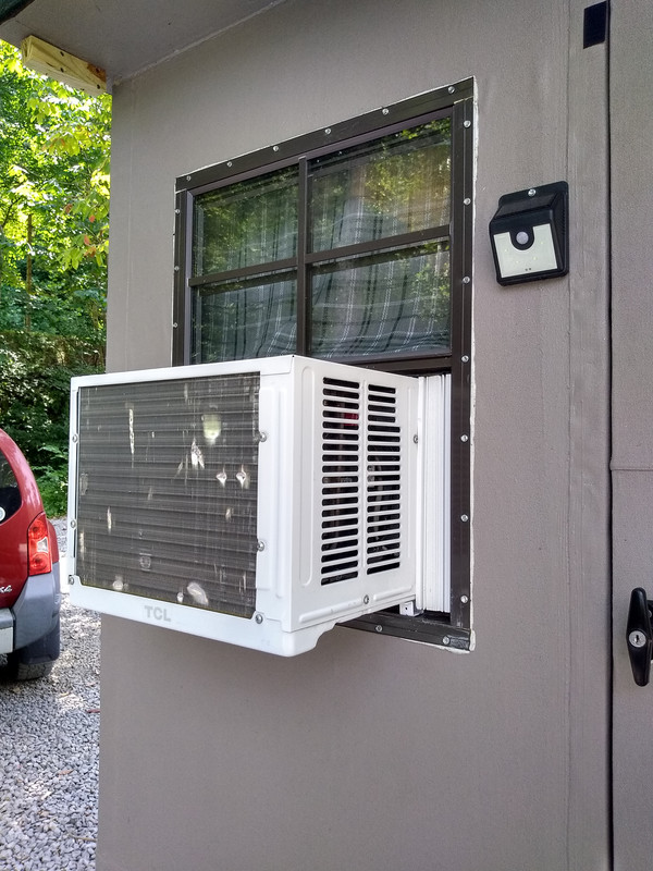

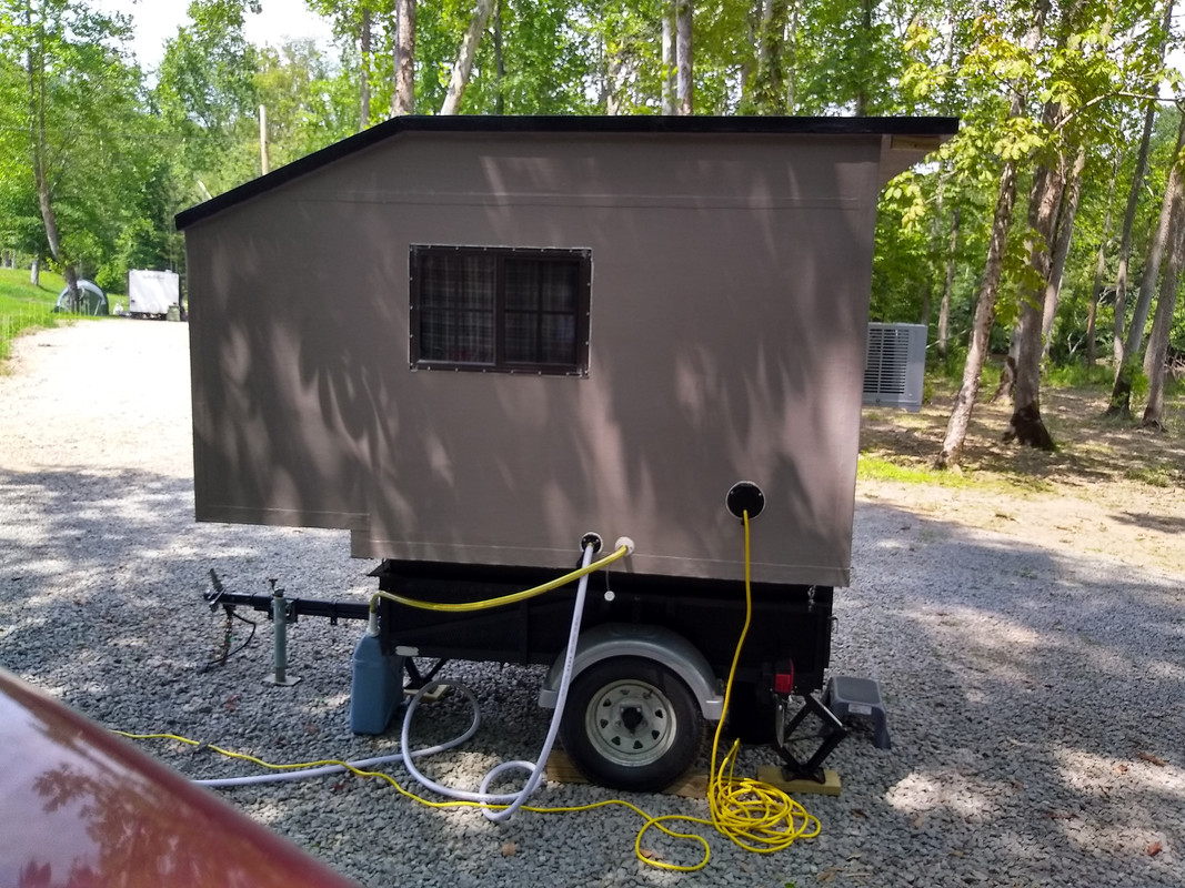

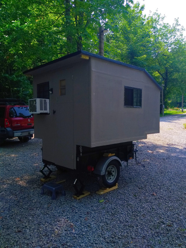

Power is 12v or 120. I have an inlet that runs to a surge protector that's mounted to the wall beside the back window. That window will fit a 5000 BTU AC unit no problem, which I can run off of 120 or my Champion 2000 watt inverter.
When the AC's not in use, it can be removed in 5 minutes. I always remove it before traveling anyway.

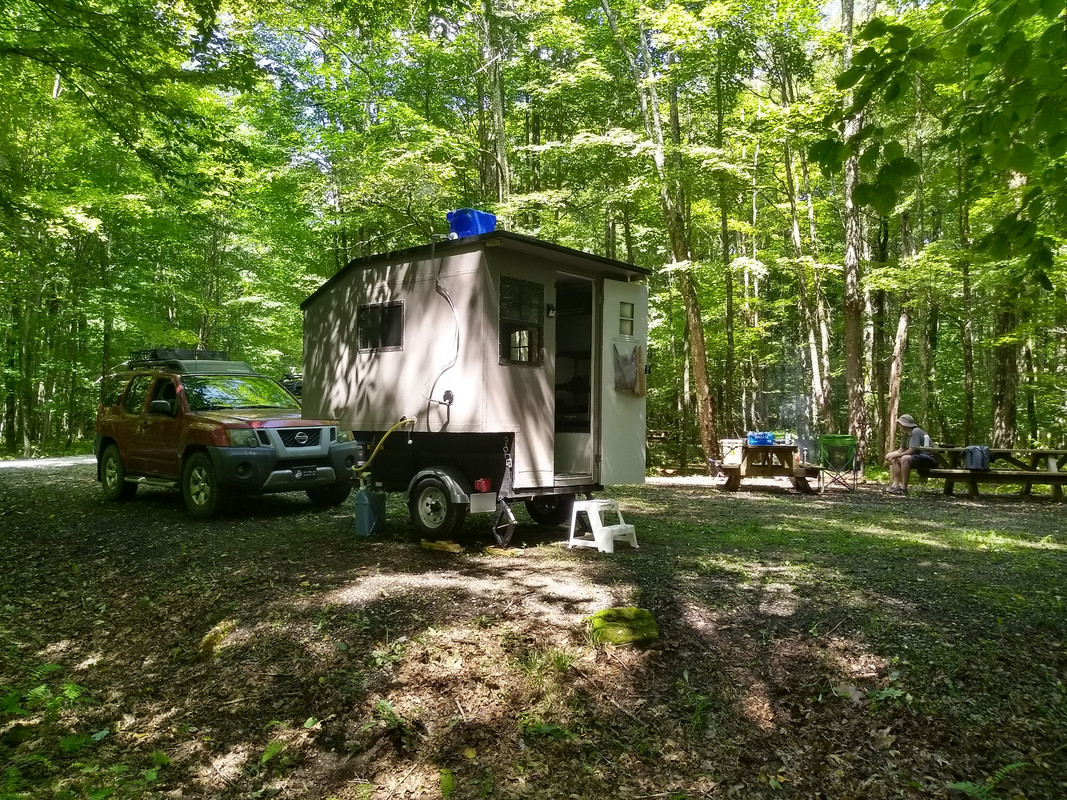

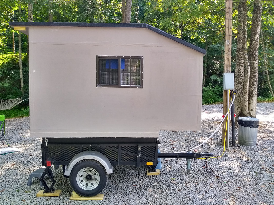

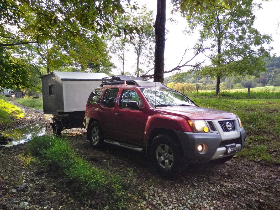

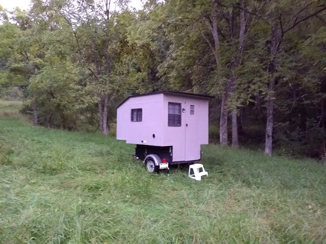

So, without further adieu, here's some pics of the outside of the camper:

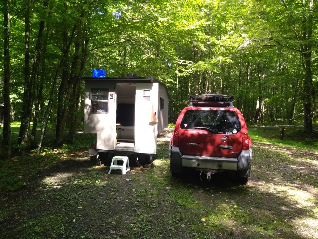

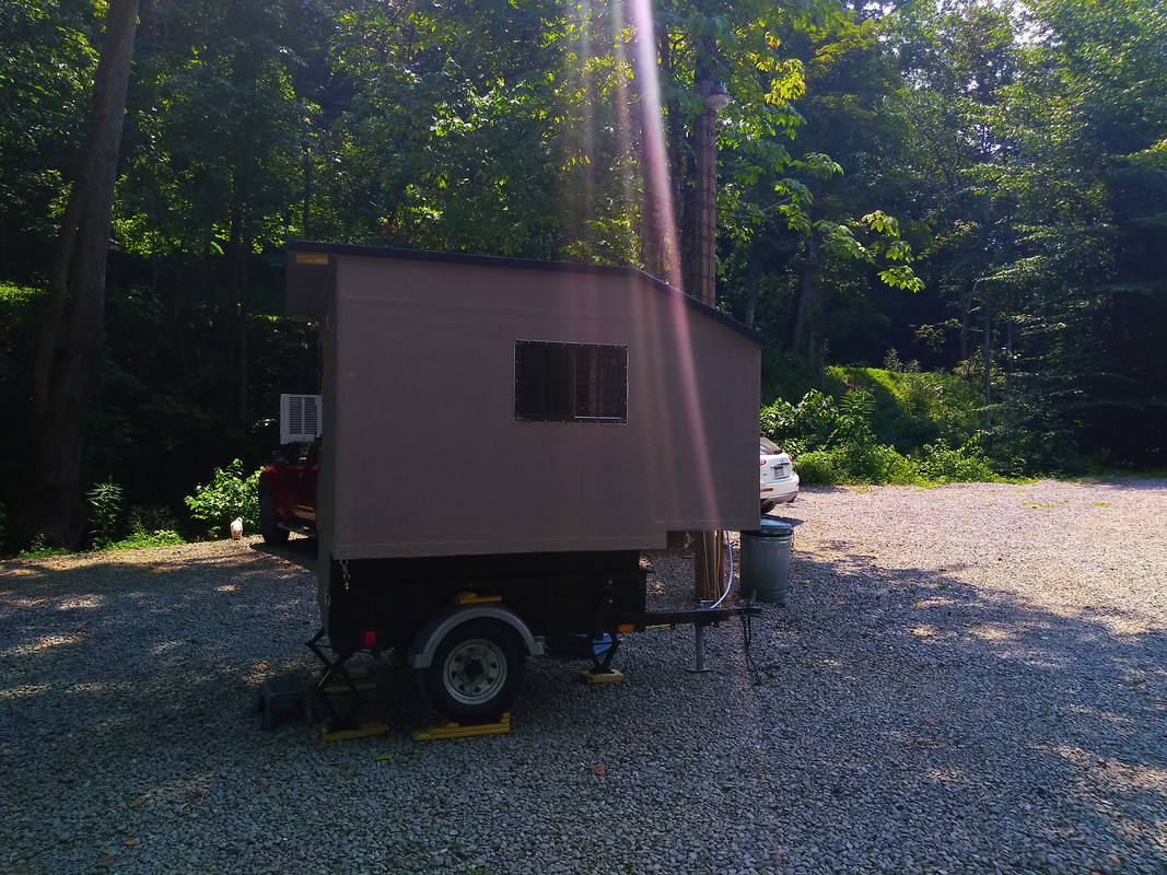

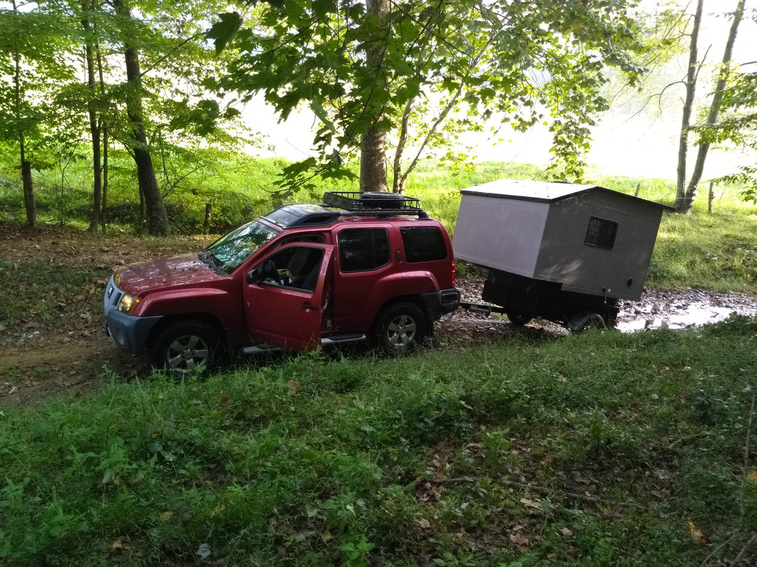

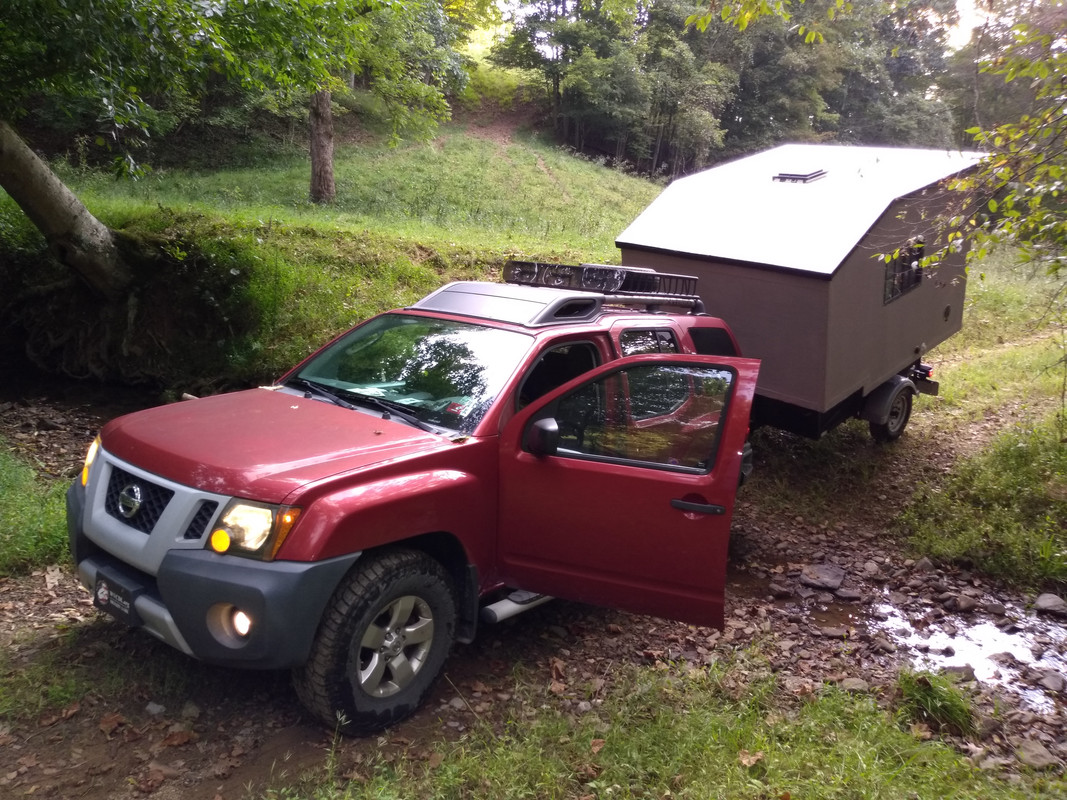

And some pics from actual camping trips I've done with it:
Boondocking in the National Forest:
At my brother in laws farm:
At the local campground...river is just out of sight to the right.
View of the river from the backdoor of the camper.

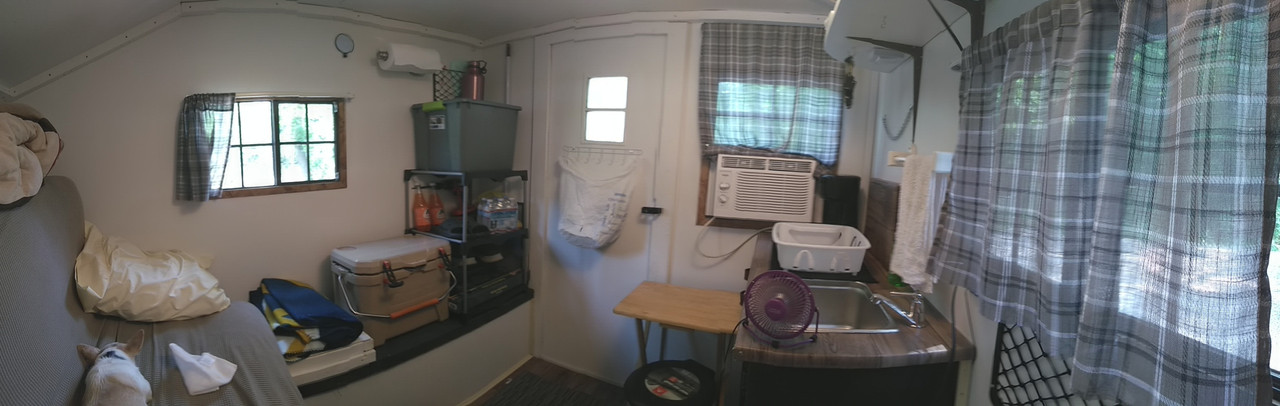

Panorama of the inside of the camper. Notice the pup on the left...lol...we both got overheated that day and sat inside soaking up the AC.

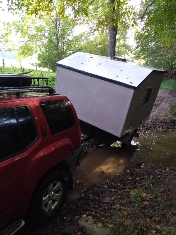

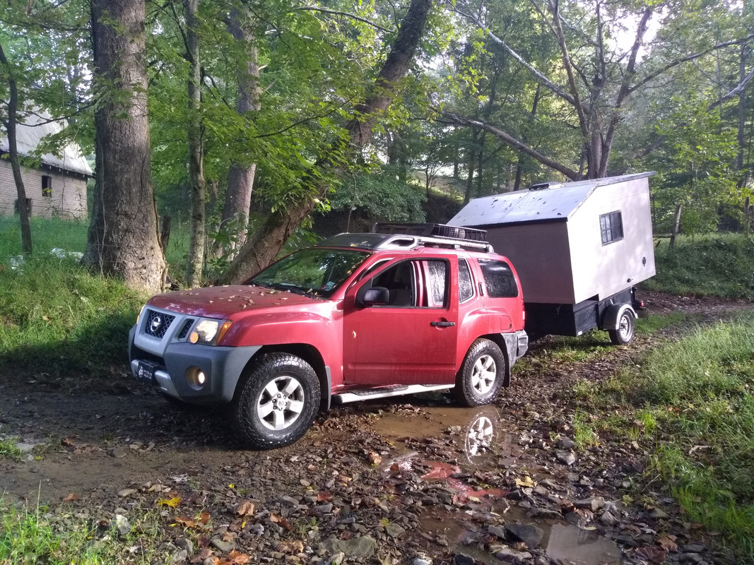

Not at all. And the first time I saw it on the trailer, I was sure I'd messed up. But, you can take this thing on some decent inclines and off-camber areas and it just goes right over them without any wobbles or tippyness. One place I camp actually has a creek for a road (lol...gotta love WV) and the camper handles that with no problem at all. See the pics:
3) How easy is it to take off the trailer?
Don't know. Haven't done it yet, LOL. Wife's especially happy about that one. Kinda got ahead of myself. I saw another poster here with an idea for making jackstands using scissor jacks and I might give that a try sometime. Until then, she's a one-piece unit.
