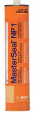

I have not used that sikaflex but have used 252.
I changed to the posted that comes in several colors, Sands and rebonds excellent to itself after roughing,
Then Cleaning with MEK (wipe on wipe off) Re Apply as needed. :thumbsup:
Both Polyurethane, My results have been stellar
I have used "High Gloss" polyurethane sealer on plywood as in the mix, and cover over with the caulking sealing it, always cleaning with MEK prior to moving on; that part is nasty.
Sorry to read about your experience, your results may be different, different product but I sure would try it.

Now thinking about how to fix this mess. I hadn’t considered the possibility that additional Sikaflex could adhere to itself after curing. I'll do nothing without testing, but, could I reasonably expect that to be true for polyurethane adhesives in general. Also is MEK any better than acetone for preparing its surface?

They are both great product's but spendy, I wouldn't hesitate to test.
My sikaflex only took seconds and I knew it stuck :lol:
MEK was hard to find and expensive Sherman had it here. Scratch and clean everything.
The MEK was recommended buy the paint manufacture; it's pootent. I was using and it makes the thing's I used sticky again just before another application, The grinding didn't make a huge mess and for the most part it isn't dusty.
