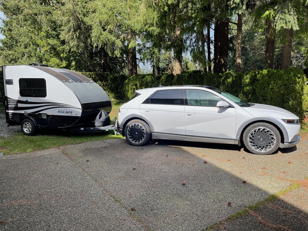

Postby hwitten » Thu Apr 14, 2022 11:50 pm
Hoping to use my Hyundai Ioniq 5 as my TV. At the moment I take about a 50% hit on range at 100 kmh.
Trying to improve on drag as much as possible and what comes to mind is the undercarriage being fully exposed.
Wondering if it it would be worthwhile to close that in to make for smother airflow on the underside.
For the boxy rear I'm planning to install Airtabs on sides and roof.
Hoping for some suggestions to add to the pot posting.php?mode=post&f=2#

I think I'd do the air tabs first. That flat rear is a huge airflow change and low pressure area, especially at speed. Truck fleets don't use them to be stylish.
That's the issue with this trailer and I don't have any idea how to fix it. It's not the undercarriage. I've seen a few semi-trailers that have baffles in the rear but I have no idea how effective they are.

In my career, I worked on a few aerodynamic studies, and suffice it to say, it's a very difficult problem to analyze in detail and make predictions about. That said, the general idea is that creating turbulent air is bad. It takes energy to make turbulence, which of course comes, ultimately, from your fuel. The square back on that trailer is particularly bad in that regard since the air tries to move into the (relative) vacuum created behind the trailer as it moves down the road. As the air moves in, it creates turbulence. The intent of the baffles is to help smooth the airflow in the back and reduce the volume of vacuum that the air tries to move into. But we all already know all of that.
There are three ways to study the problem, only one of which seems to be practical for us. The first would be to use a super computer* to try and figure out the best length, and angles for the baffles, and the second would be to build accurate scale models and test in a wind tunnel. The practical method is to make some reasonable looking baffles and experiment on the road. My guess is that your first attempt will produce the biggest improvement, and any tweeks thereafter will be minor, but I might be wrong about that.

Um, aerodynamically it doesn't get much better than that and EV's aren't really designed to tow. Maybe try towing a different trailer just to see how bad it can get.

agree with everyone here..... what I see here looks about as 'aero' as you can do....Looks Good!!....... something you may want to research into would be building some kind of a fixed short (maybe a foot or two) awning 'rearward' off the your trailer roof edge backend (kind of what is on your own vehicle's rear deck lid hatch in horizontal level with your vehicle's roof line) the picture posted here of the 'Trailer Tail' kind of shows it also at it's trailing horizontal upper edge = it helps in getting the air off the roof and further away behind the trailer, so when it does drop = the turbulence being created happens away from the trailer as it falls off. I am thinking some kind of 'fixed' awning could be built that could also serve 'double duty' as a kind of a rain guard/overhead cover for the back galley area when camping also. Just a thought........

That flat rear is the killer. Unless you can streamline the rear, I don't see much being gained via other means.
I doubt that it would be very effective, but perhaps a spoiler might help.

To make any type of improvement you need to know where the drag is coming from. The cheapest and fastest way for a person without a wind tunnel is to use tape and 2" to 3" pieces of string. Do straight lines across the body or bodies to be tested. Make the rows about 12" apart. Go for a drive and video tape all tape strips to see what the strings are doing. Then experiment with air tab's to even the flow out as best as you can.
