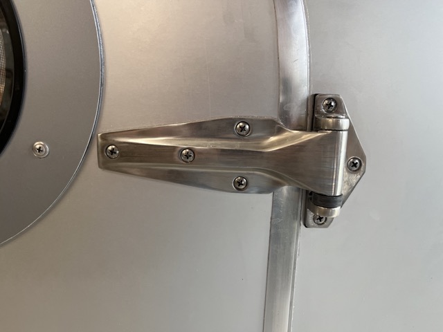

I'm in the process of installing the doors and using these heavy duty freezer hinges. I'm using stainless machine screws which mate with T nuts on the interior. After installing the first door it dawned on me, if someone wanted to "get into" my trailer (when the doors were locked).... as in "break in" ....all they'd have to do is unscrew the hinge Phillips head screws holding the hinges to the body.
Any thoughts on this? When you (members) install hinges do you take precautions like using one way screws, carriage bolts of some variety, or just not worry about it, not think it's an issue?
thanks
John

John, I see you're using Phillip's head which are very common.
Using #2 Robertson or anything unusual might be a deterrent as long as the thief didn't have his battery powered sazall with him.
Smooth head bolts might be a good choice too, but may come in chrome.
I have stainless piano hinges which has no security issues.
The typical teardrop door handle can be unscrewed when locked, and used to open the door.
They could also break a window to gain entry.
:D Danny

Thank you for the thoughts.
halfdome, Danny wrote:The typical teardrop door handle can be unscrewed when locked, and used to open the door.
I did catch that and drilled a small hole at the end of the shaft and put a cotter pin in the hole, so even if the 2 screws were removed, it would be difficult to remove the handle. That'll show em'.
I think what I might do is just remove 2 screws on each hinge half and replace them with stainless carriage bolts, swap out the corresponding T nuts for hex nuts. That'll also show em'.
I don't know that I like the idea of 1 ways screws, in case I need to remove the hinges at some point.
I suppose if someone really wanted to "get in", they're gonna do what they're gonna do.
The supplier sent 4 keys. I would hope between my wife and myself we don't loose a key. I think all these camper handles are keyed alike anyway. I can just borrow the camper's key in the next site.
thanks again.
John

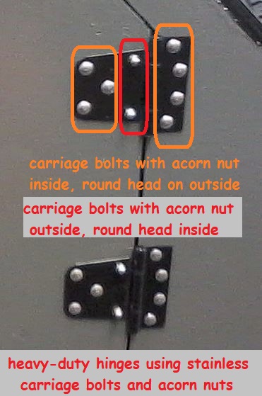

Postby working on it » Mon May 23, 2022 9:19 am
JasenC wrote:John, there's a number of different styles of security/tamperproof screws, check McMaster, Fastenal or Amazon.
* I initially designed and built my 4x8 squareback trailer for my wife to have a secure place to store her stuff and sleep in, while "solo" camping with her girlfriends. I built it of strong materials, bolted and glued together, and used heavy-duty hinges, hasps, latches, and locks to assure security. I used two latches where one should do, and three hinges instead of two...the same principle was followed for bolts, nuts, and added padlocks (for added security).
* She never used it, so I do. But the extra measures I took keep the trailer super-tight and solid, after 9 years of use. I used mostly carriage bolts for construction, with the round-head facing outwards on door hinges and latches (except where the head width made me put a narrower acorn nut facing outward), so nobody could detach a door once locked, without power tools. The same was done for the two windows, but with "Tamper-pruf" one-way security screws instead of bolts.

Another method, using the hardware you already have, would be to peen the threaded end of the bolt where it comes thru the t-nut after assembly. That way the outside looks nice and and you can still dremel off the peen and turn the bolt out if need be.
