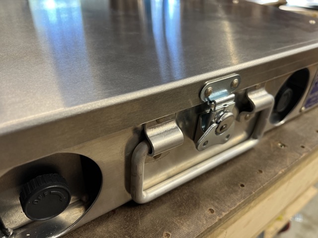

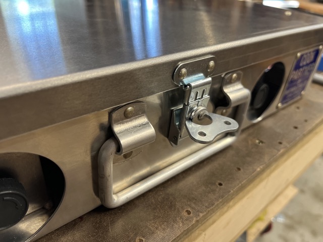

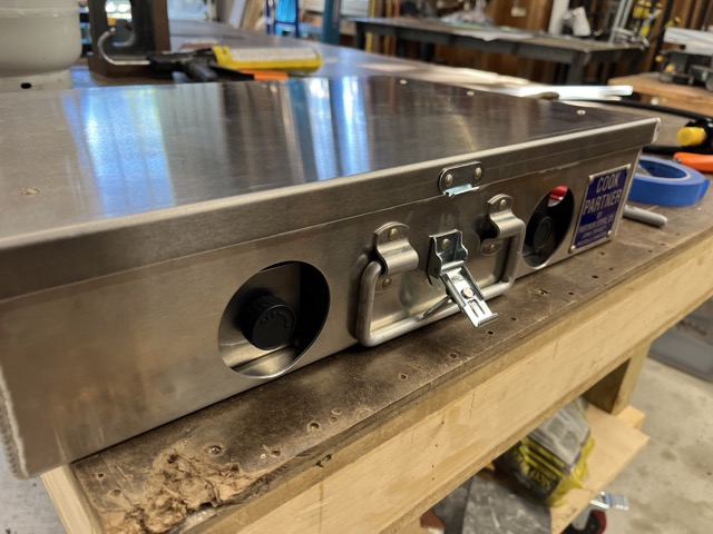

here's some pics of the hasp. It's an interesting hasp in that you need to push down on the top of the lid and flip the bottom part of hasp up to catch lip
of upper hasp piece. You then turn the little key shaped piece and it has a cam of sorts, pulling the lid down further and fully. Then you turn the key shape and fold it closed.
Notice the space between the rivets and the handle holding fixtures in the first picture compared with the space in the second picture where the hasp has grabbed the lid to close it fully.
That is the amount of space it needs to pull it to fully close. If the lid wasn't binding on the back hinged it would be resting in that position without the hasps closed. I'm wondering if it's meant to be this way??

Capebuild wrote:here's some pics of the hasp. It's an interesting hasp in that you need to push down on the top of the lid and flip the bottom part of hasp up to catch lip
Our hasp does work like that. I haven't looked at the hinge to see if that's part of the reason. You do need to have the little wires--that hold the wind guards out--above the grate for it to close properly.
Which gives me an idea about your first two questions: Is the grate properly seated in the gas inputs for each burner? We haven't had those problems.
On our Coleman, if the burners are wet, they won't completely light until they evaporate off the water. So that's something else to look at.
