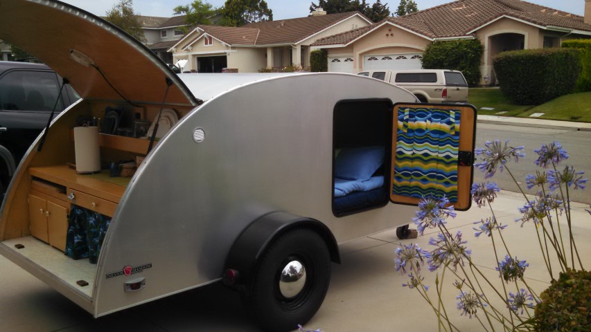

Postby sweetnsaurer » Thu Dec 08, 2022 10:55 pm
Great topic...We could use some advice. Our galley hatch is leaking and taking it in for some weatherproofing in 2 weeks. I have always wanted to get an awning off the back but needed the C-rail. Thought it might be a good time to do this since they are working on it anyway. How does the c-rail attach to the hinge? And what size would I get? Any direction would be helpful. BTW I have a 2006 Yoder Toter Silver Shadow.

Postby Shadow Catcher » Mon Jan 02, 2023 8:13 pm
I use Marine grade Kedar rail on three sides of the tear held on by 3M VHB tape It has withstood storms.

Postby sweetnsaurer » Mon Jan 02, 2023 8:53 pm
3M VHB tape...
Wow really? I never would have thought of using tape.
Thanks for the idea.
