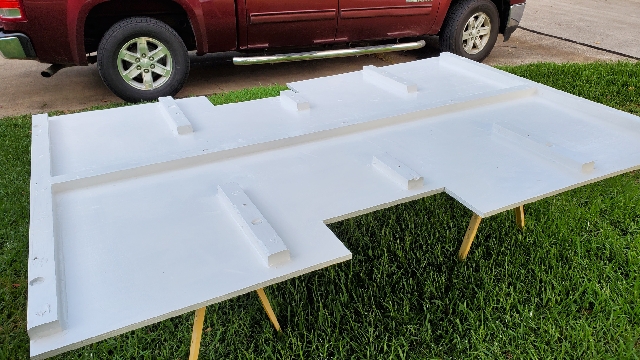

Postby philpom » Thu Nov 24, 2022 12:22 am
tony.latham wrote:
the reality of what already exists so any potential solution must apply as described.
Sorry about that misunderstanding. Is the 2x3" that is sitting on the trailer frame treated with something?
No worries, the drawing gave the impression it was a "plan". The 2x3 is glued, caulked, primed and painted like the rest of the underneath. It's the board on the left. This is upside down prior to going on the trailer frame.
