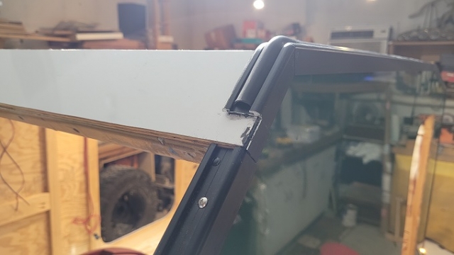

Postby Onajourney » Fri Dec 09, 2022 9:23 am
You need to turn down the roof ~4" to make the hinge work. I made the same design mistake initially too. It was not a big deal except for making skinning it with aluminum more involved. Here is mine.

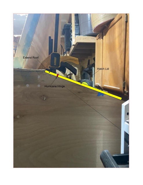

Here a a couple of pics. Not the best still digging it back out. Image

Postby Onajourney » Mon Dec 12, 2022 1:01 pm
This is what I mean. The roof and hatch need to be on the same plane. My front roof is on a 7 degree slope. I have a build journal if interested.
