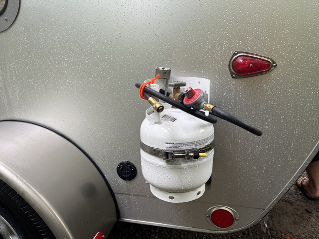

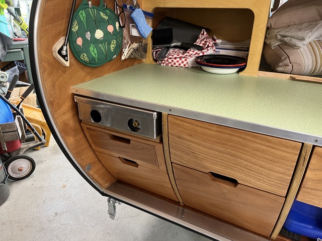

Currently my propane line feeds only our Partner Stove which is located in the galley. I need to have it on the cabin's exterior and it connects with the stove from the stove's left side. The downside of this is the galley hatch cannot be closed while having the stove connected to the propane line. I'm looking into getting the stove's inlet revised to be on its right side so I can reroute the propane line on the galley's interior, allowing the galley hatch to be closed without needing to disconnect.
I see 2 ways of doing this, 1) to route the line down the side of the cabin, running it under the cabin and coming through the floor to connect to the stove and 2) going through the cabin's exterior wall and mating with the stove (this way it's much more direct and much less propane hose).
Anyone see any advantages/disadvantages approaching this revise (one way over other)?

Before you drill any holes keep in mind that the Partner Stove requires a High Pressure regulator and a hose with a proprietary fitting on the end. That hose is used and sold only by Partner Stove. Common 3/8” flare type LP gas hose and standard low pressure regulators will not work (according to Partner Stove). Will they also be supplying your new gas line?

Thanks, Rob. Yes, I'm aware of the particular hose/regulator used with the Partner Stove. I would intend on using the same (original) hose as is currently used, just need to route it to the stove in one of the 2 ways described in men original post... and wondering if there's any input on which might be the best way to do it.

I’m trying to envision how the short hose in your image could be routed from your side mounted tank,through the floor and back up to your stove... Perhaps it’s longer than it looks!

I'm a big fan of keeping things simple, so my first reaction is: why do you want to have the stove permanently connected to the propane hose? We too have a Partner with an external propane tank, and we simply connect the hose on both ends when we want to use it. I suppose you can imagine a scenario where you pull off the side of the road, lift the hatch, slide out the Partner and light it without having to connect the hose, and that would indeed be easier . . . but it's really not so onerous to attach the hose. And that always leaves the propane hose stored safely in the tongue box or the heater itself.
If you do decide to route the propane hose into the cabin, I'd think it would be easier and more direct to go in through the side;. I did this on my teardrop for the Propex heater connection, and used this fitting: https://www.amazon.com/gp/product/B07D6NZLXF/ref=ppx_yo_dt_b_search_asin_title?ie=UTF8&psc=1. I had a propane hose custom made for the permanent interior run from the fitting to the Propex.
My last thought is that if you want us to comment thoughtfully about your propane connection, you're really going to have to crop or blur out those beautiful curved cabinet fronts, because it's hard to focus on anything else while they're in the picture.

TCJ wrote:My last thought is that if you want us to comment thoughtfully about your propane connection, you're really going to have to crop or blur out those beautiful curved cabinet fronts, because it's hard to focus on anything else while they're in the picture.
Exactly what I was thinking. I don't remember John going over this in his Build Journal. I bent some poplar a few years ago and it was not easy.
