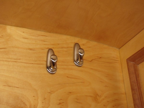

I've seen a storage space located under the door opening as you enter or exit. Basically, it's a shelf or drawer that keeps shoes dry when sleeping. We added a couple of coat hooks for hanging space, they're just behind the door on the inside.

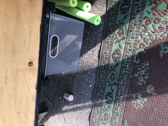

Yes, coat hooks (command hooks) by each door. Our shoes are in a basket that slides on two rails under the doors. Removable for travel. Image

nevadatear wrote:Yes, coat hooks (command hooks) by each door. Our shoes are in a basket that slides on two rails under the doors. Removable for travel.
What an awesome idea! What did you use for the brackets?

Postby nrhmaine » Mon Jan 16, 2023 5:13 pm
nevadatear wrote:Image
This is such an elegant solution! Well done!
I imagine a couple pieces of aluminum c-channel could serve as slides. I'll stash this idea and steal it later. (I'm doing my best to differentiate between tasks that are essential to the build, and those that can be put on a to-do list after it's "campable")

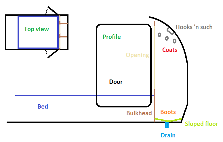

I am on the wrong computer to share a floorplan or profile view, but my 'rough road' TD design breaks from the norm.
I have a footwell with a drain, at the head of the bed (front of trailer body), in the bottom of an open 'closet', for boots and coats to drip, drain, and dry. (Right side / US passenger or curb side.)
Warmer weather isn't an issue. Shoes/boots go wherever seems "safe" - which might even be in the vehicle, with flip-flops into the trailer.
But warm weather is not my concern.
Primary focus for the build is hunting and quick trips into the mountains in the Fall.
With that comes a lot of cold, plenty of snow, and high potential for rain and mud - while being out in the weather, not just in camp with a little exposure to it.
My feet can't handle cold boots. I can't leave them outside. If I put frozen boots on, my day is done. My feet will be cold all day, no matter how active I may be.
My boots need to be at least as warm as they would be in a good tent, my boots often need a chance to dry (but don't stink), I don't want them on the bed, and I don't want to be sticking them in a tote and then shoving that in a corner. So, I am making sacrifices elsewhere and building a footwell for boots.
However, dedicating the front 12" or so of the living space to boots, coats, and storage has a knock-on affect on everything else. It pushes the bed back, which really requires moving the doors back. Which conflicts with fenders. Which causes axle relocation contemplation. Which may impact tongue weight. And the bed moving rearward impacts rear end storage (or galley, but I'm not building a galley), which limits utility and space there. And on, and on. It even made me have to change the profile of the roof, because I had to shift the roof vent back.
The need to be able to swing my feet through the door and into the footwell also means the doors are farther toward the head of the bed than is ideal - a situation that some people really dislike.
On the up side, that same ~12" of room on the other side of the trailer gives me a nice location for the electrical center, some convenient clothing storage, and forced the location of the furnace to be settled.
I whipped up a super special, high quality sketch in MS Paint. (Not to scale. ;) )

Postby nrhmaine » Tue Jan 17, 2023 12:59 pm
That’s clever. As you may know, a “wet locker” is a common part of sailboat design. Just inside the companionway there will be a ventilated locker to hang wet, salty foul weather gear when coming off watch on deck.
Great functionality for a hunting teardrop.

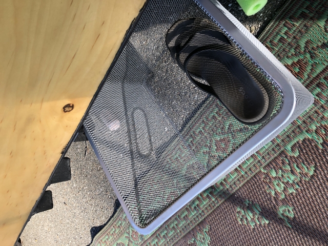

Postby nevadatear » Thu Jan 19, 2023 5:34 pm
We also have drop down storage at our heads that we can use for shoes inside as well. As for the brackets, my husband took I think a 2 x 2 and routed a groove. It is not our original idea, we know several people who have used an "L" bracket to hold the baskets. That wouldn't work for our frame. Image
