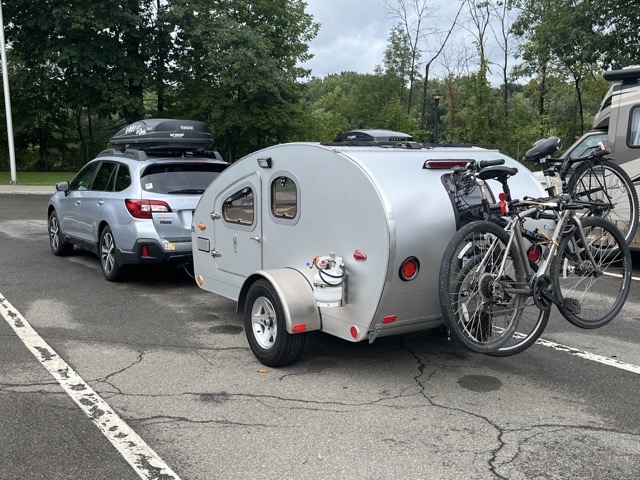

I'm revising the way the propane feeds my stove (which slides in and out in the galley). Currently the connection is made on the outside of the trailer from the propane tank mounted on the trailer's exterior sidewall. I'm changing this so the propane hose will go through the side wall, run though the trailer interior and connect to the stove inside the galley (around where the blue dot is in the attached photo). I'm thinking it's probably a good idea to install a propane detector in the trailer's interior.
Anyone else have a detector installed in their trailer? Just curious. Thanks
