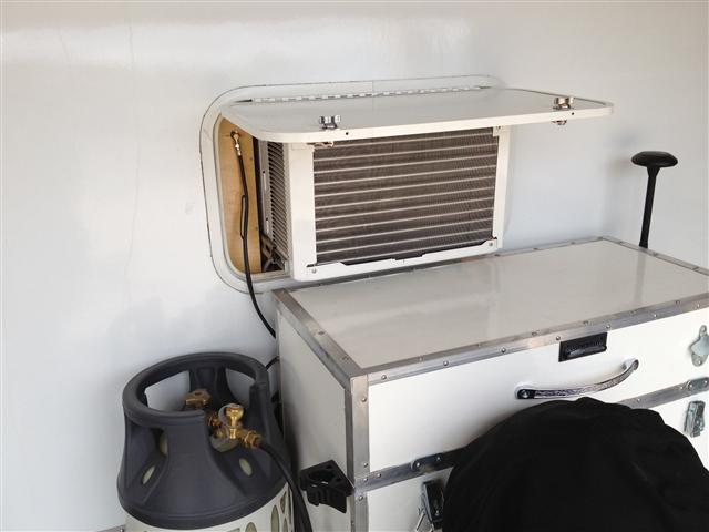

I put a 5000 btuh A/C on drawer sliders behind a baggage door. Works great but it might be kind of tough to install after the trailer is built.

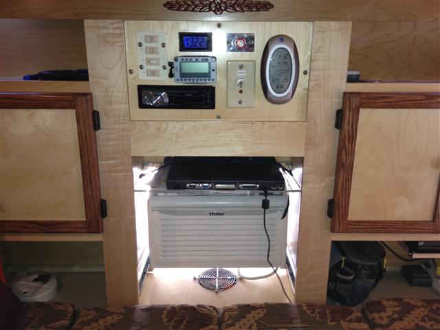

I paid a couple hundred for a window unit and mounted it permanently in a box in the front of my standy.
Time will tell, I hope it works out.
