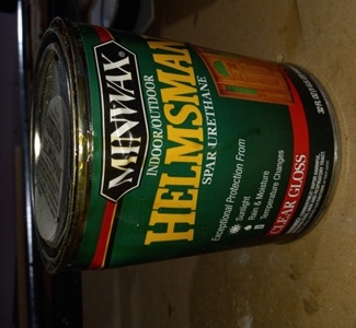

I used the Monstaliner over,
PolyU UV GLOSS.jpg (53.15 KiB) Viewed 775 times
then this: (Wood) till or if? I put a Picture up.
Sprayed it!
They Sell A good Gun and Have Directions for thinning :thumbsup:
