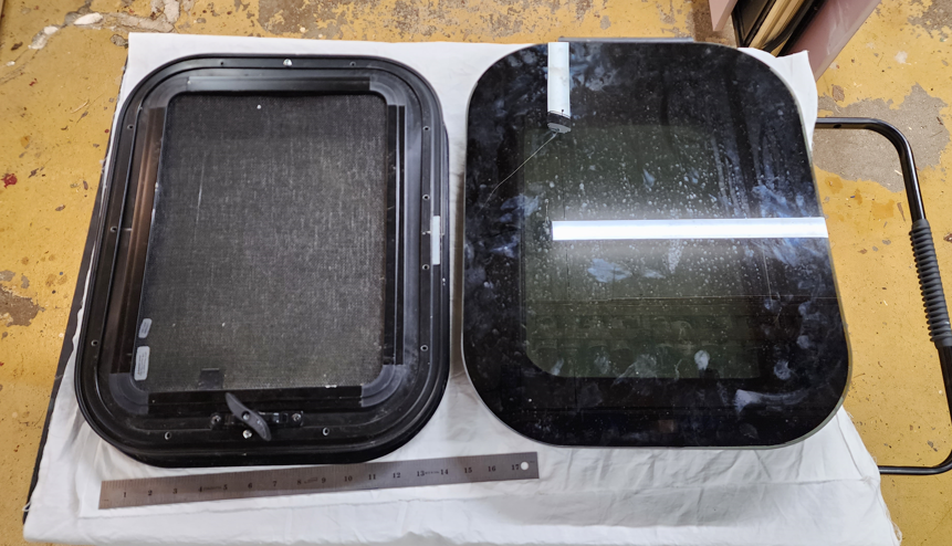

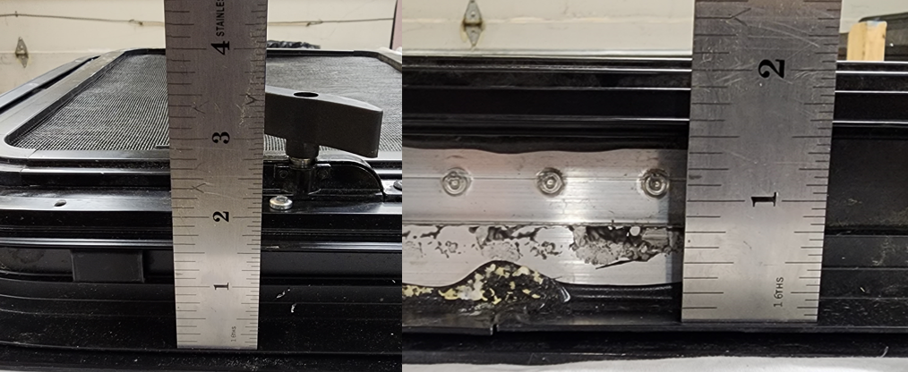

Here is where I am looking for some advice... when I measure the windows to determine the WALL thickness they were designed for, I measure 1 3/8" from outer frame to inner frame with trim ring.
(Looks deceiving, but trust me, when the trim ring is sitting metal on metal, the distance is 1 3/8".
Does this mean I should be planning on 1.25" thick walls? (Leaving room for tape/seals?)

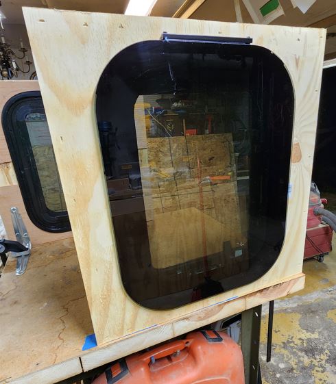

Here's my solution:
Re: Sanity Check: Wall Thickness
Postby MickinOz » Sun Jul 30, 2023 1:30 pm
I did the same as Tony. I had doors suited to 34mm thick walls. My walls were 17mm plywood, so I cut a couple of 17mm "collars" glued and screwed them to the walls, and trimmed to the cut-out with the trimmer bit on the router.

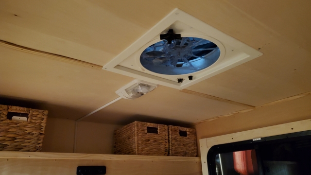

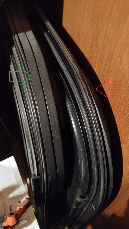

Trim rings don't need to sandwich the whole window or door, they just need to secure the frame and hide the rough hole.
I don't have a better photo, since I have not been able to build my body yet. But I have already modified these trim rings to handle any wall thickness. They were designed for something like 1.5-2.75"; but I intend to build 1.25" walls (possibly thicker now, with redesign). So I got rid of the overlap and made them slip over the outer edge of the body. Actual trim ring, not a compromised sandwich half that stands off weirdly because it was installed in an application outside of that which was intended.
(Green arrow / left side are rain gutters. Red arrow / right side are trim rings, all the way against the outer flange.)
I like actual trim rings, not things made to have a hard stop in a specific application but have to be adapted or shimmed to work in any other. :shrug:

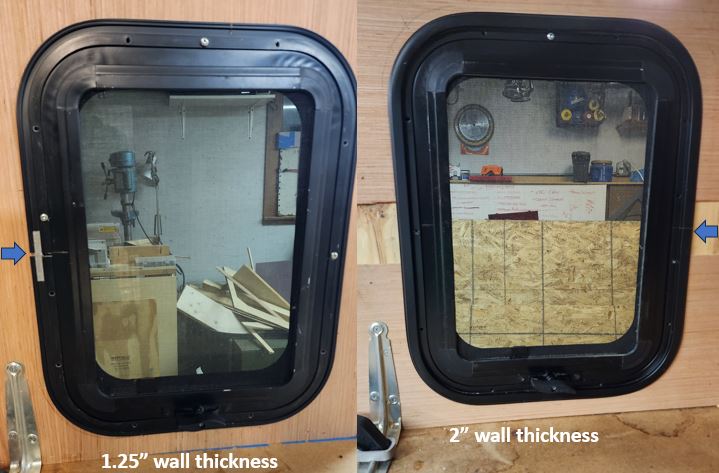

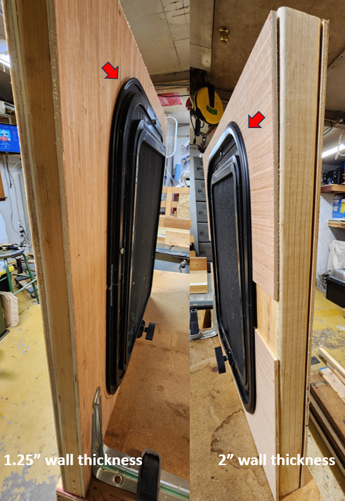

I made some "test" walls today to see exactly how these windows would mount up.
I built two different wall sections. One was 1.25" thick, the other was 2" thick.
Side Profiles
wall thickness side example.PNG (956.33 KiB) Viewed 873 times
View from "inside" looking out.
wall thickness examples.JPG (64.45 KiB) Viewed 873 times
The trim ring flipped over and mounted for the 2" wall seemed to lie correctly against the wall with no gaps (red arrow), and the metal piece that "clips" the trim ring together was hidden (blue arrow)!
From what I can tell, the trim rings would work for either thickness... they "fit" better with 1.25", but the LOOK better with 2".

So, based on these tests, looks like I will be aiming for 2" wall thickness! Plenty of room for insulation!
