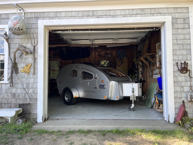

I currently keep my trailer in the garage when we're not using it. My garage also functions as a "shop" of sorts and I'm starting to think of another place to store the trailer in order to get back the shop space.
I was thinking of constructing a separate "building" just to store the trailer, but that seems to be more of an expense I'd like to deal with. I'm now thinking of a car port of sorts (basically just a roof) that would attach to the garage
but am concerned about the trailer being exposed to the elements. We are located in the northeast where rain and snow can be an issue. I was also thinking of one of those big car tents but was concerned about
moisture coming up from the ground below. Maybe my concerns about exposure to the elements is overblown.....??
My question is where do you all store your trailer, especially you who are located in climates that might experience winter like weather, moisture, excessive Mother Nature....etc..
Thanks for any suggestions, input and the like.

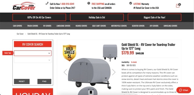

I'm still trying to figure out a way to get my trailer out of the garage and stored in a safe and reliable setup. I've looked at both one of those Shelterlogic car tents and also installing a slanted roof on my garage to house the trailer. Both have their positives and negatives. Has anyone used one of these trailer covers (see attached)? Kind of like a car cover.
Thanks
John

I bought one and it was too small but it was so cheap and thin, I returned it and did not order a bigger one. The tarp I mentioned is working just fine. I just got back from walmart looking for a beach ball to put on the roof today. Rain sometimes collects between the awning and rod holder tube on the roof rack. No luck on the ball.

Shed roof off the side of the garage like Tony did is the best option. For a fabric cover you would want one that breathes so it doesn't hold moisture in causing mold. And you want a tight fit so it doesn't flap in the wind and rub the finish.
