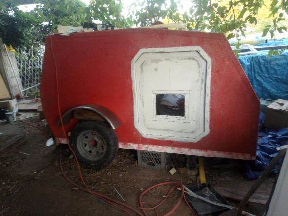

Postby saywhatthat » Tue Dec 19, 2023 11:59 am
you definitely want a vent fan in the top to help with heat and air movement .Also when you do widely Windows put them as low as you can in the doors that will you get cold air to blow across your face we use cutting boards because they're tempered glass for the windows
