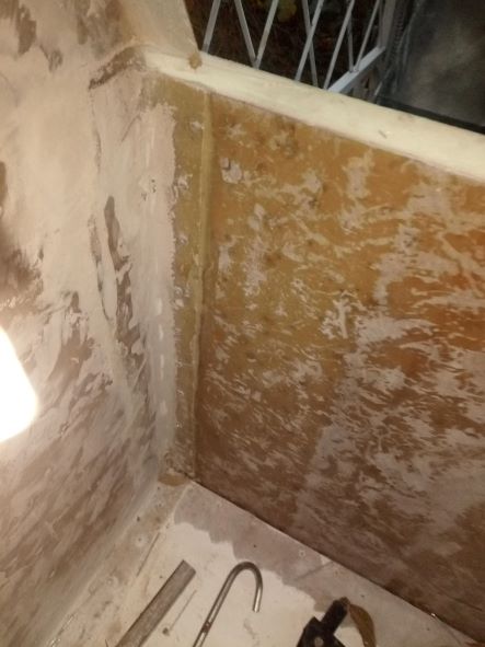

Postby saywhatthat » Sun Jan 14, 2024 7:33 pm
ploy over wood . do more research! if you are where it freezes will lift the glass if water gets under. make sure you pant it . ploy has pores If you are going to glass it why waste time and cash and weaght . with ply wood . There is cheap foam that ploy does not eat
