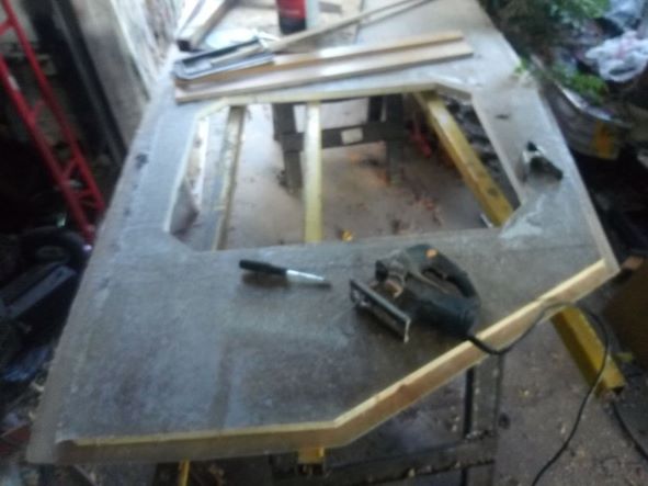

Postby saywhatthat » Thu Feb 08, 2024 12:54 pm
They're so easy to make and cheap to make. we do ploy and foam using $12.00 hardboard as a mold just look out for the expoy liers . No one makes them here to sell to cheap and easy to do your own . About $100 for 4.5 by 9 with 1'' foam with $50.00US setup to make
the way we do it makes a near-indestructible pod you can make your own end caps
all so look at this video https://forum.expeditionportal.com/thre ... 43/page-21

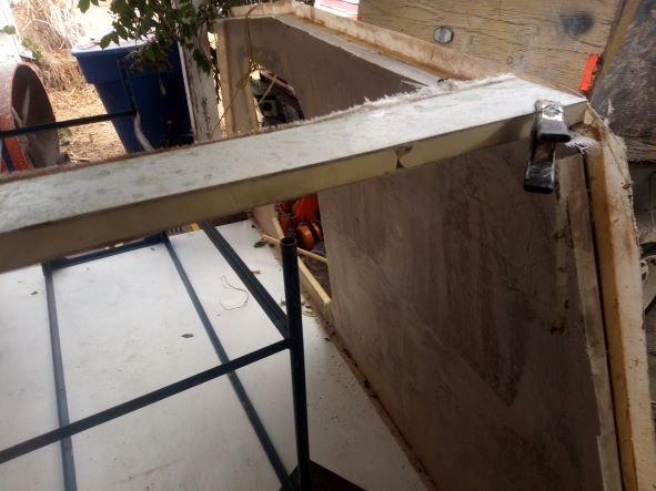

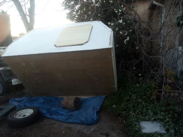

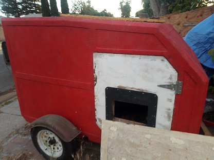

end caps for walls1.5 mat 7oz woven 3/4 mat for skins
we have two 8 year old building pods
cut sides lay top on glue end caps . run 4'' wet layup on inside fell gap with can foam done with pod . pods under 200 lbs

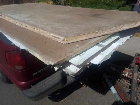

to make the panel take hardboard wax 3 times. paint gel-coat after gel set one laider of 1.5 mat wet out with dollar store roller then 7 oz woven what makes it so strong. then wet layup with 1% catless 3/4 oz mat. shove foam input stepping stones on top. the next day take resin over top of the holes. You can tell if you have any voids then in side 1.5 mat 7 oz woven 3/4 mat that lip on side wall is made by 1.5 offset on your saw .any gap is filed with can foam
