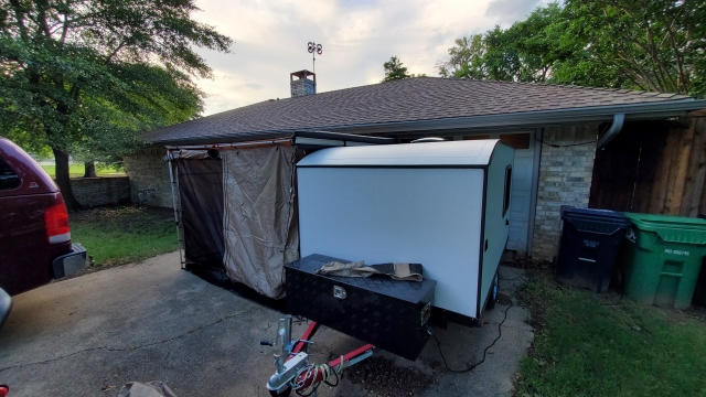

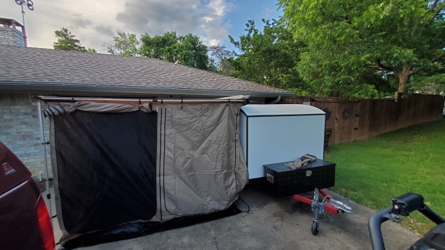

Next up is a pure luxury item - a room for the awning. This will give us a private space out of the sun and bugs as needed - a place to stretch and get dressed!
Our camper has an All Top awning on it, they don't seem to make many add-ons for it so I took a gamble and purchased the ARB Touring tent room. This room has a floor, all sides open for windows with screens and the end extends out for an additional awning. I can confirm, it fits perfectly with the All Top awning and probably others.
Can't wait to try it all on and will certianly note here any interesting observations! We also picked up some USB rechargable 10" fans, these should be great and will run directly from the solar or recharge since they have built in 10,000 mah batteries that can work as a power brick for your phone.

Turns out I could top off the battery each day before noon. We even ran string lights all night each night. I'm redoing my battery box this weekend and got a 2 way battery monitor today that will provide me more details on my usage and charge rates going forward. I'm guessing I over estimated our daily need by some amount and we'll find out soon.
It was also EXTREMELY hot at that park, thank goodness it was a short hike to natural spring pools you could take a dip in. The cascading waterfalls with a pool below each one was amazing and cold! I bought an AC today and it gets installed in the next week or 3.
The room was fantastic and worth it 100%. Easy up and easy down, it provided a great place to chill, play games with the kids and enjoy a late dinner in relative comfort away from the bugs - we camped on the edge of the Colorado river, the bugs were pretty thick and the trash pandas were "in your face" :)
