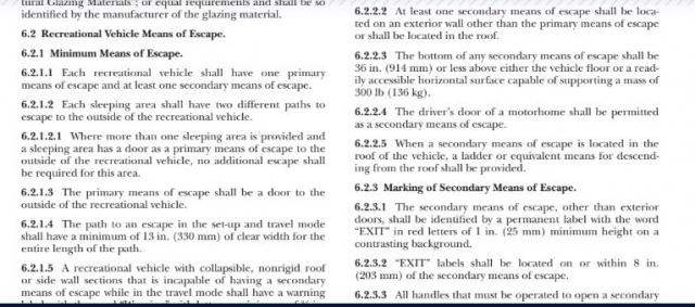

Apparently you do, according to NFPA 1192. Who knew? I didn't until I looked for it...
You can get access to this article if you create a free user account at https://link.nfpa.org/free-access/publications/1192/2021

bdosborn wrote:You can get access to this article if you create a free user account...
Turns out I already had an account... guess I should save that log in!
And... yea.. buy the looks of it... it is "required".
Also looks like using the window smasher is not acceptable, as it "shall NOT require the use of a special key or tool."

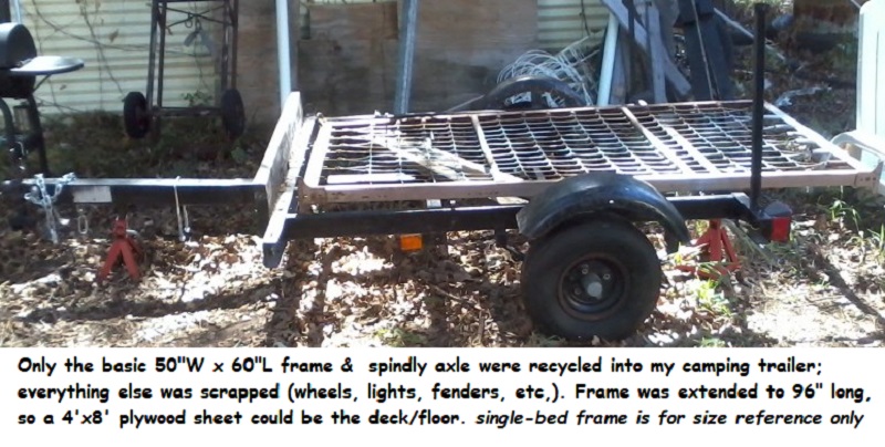

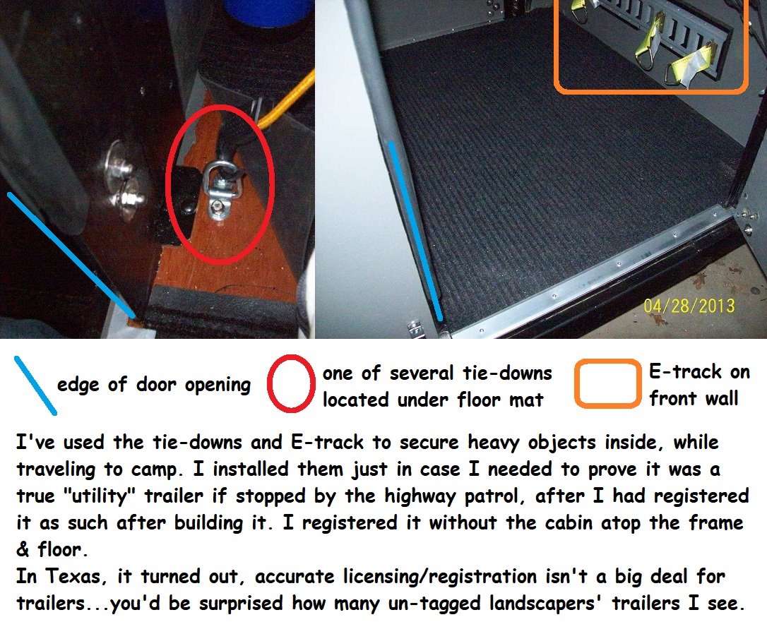

I was worried that my "recycled frame turned squareback trailer" would be deemed illegal if I was ever pulled over on the road, because I had registered it as a "utility trailer", before I built the cabin atop the floor. I shouldn't have worried, because small personal trailers aren't subject to strict inspections, registrations, and licensing in Texas, it seems. I didn't even have to show a picture of mine when registering it, and just told the clerk that the original un-readable builders' VIN tag was thrown away with the bent tongue, and that I had bought it as a throw-away at a swap meet for $50, 18-19 years previously, and it wasn't ever tagged before. No problem, got the registration done in minutes.

It's also a thing here (maybe not-so in other regions), that certain people aren't ever pulled over for their "landscaper's" trailers, despite not having safety chains, working lights, or even properly secured loads. Sometimes, I'll see the same dual-axle trailer missing a wheel on each side, with may-pops installed...obviously they're getting a free-pass from local LEO's. I doubt that I would, so I follow the requirements (mostly).
