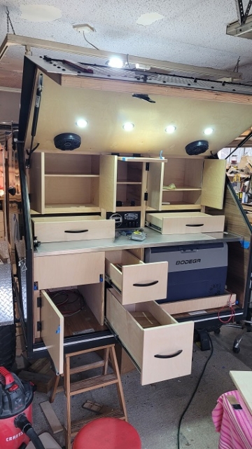

I'm on rev 3 of my next trailer build, and I can't decide if I want a galley or not.
The biggest things we decided we wanted to change from our current 5x8 are interior space and interior storage for things like clothes, games, etc. I recently bought a Tacoma and I'm building a GoFast stye wedge camper for it (for solo trips), and part of that build will be slide out kitchen and storage built into the truck bed, plus we will have all the truck bed space on top of the drawers for storage. This has me questioning if a galley is really needed or if that space could be better utilized inside. The next trailer plan is a 5x10 squaredrop.
For those of you without a galley, do you miss it?

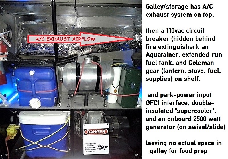

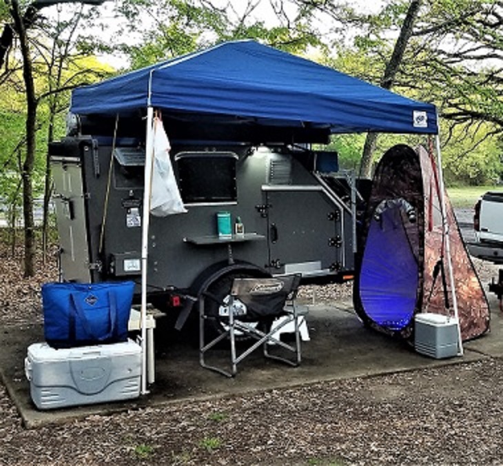

My "galley" isn't the cooking area, I set up a sturdy folding table to the side, under half of the 8x8 canopy (the other half is covering the 4x8 trailer) where I can sit in my chair, shielded from rain or harsh sunlight, while cooking. The "galley" is actually a storage area, 48" high x 46.5" wide x 22" deep, where I have:
  • 1) on the bottom: an onboard pull-out, swing-out generator, a cooler (for my frozen foods and/or fresh meat), and master electrical switches and breakers (hidden),
  • 2) on the shelf above: a 7-gallon Aquatainer, Coleman gear (lantern, stove, fuel, and extra wicks, etc,), and a 3.5 gallon extended-run fuel tank (gravity-feeding the generator), and
  • 3) the bulk of the storage space is filled with my onboard, hidden, 5000 BTU window-shaker A/C unit (mounted in the rear inside wall), with insulated exhaust ducting routed to an outlet on the curbside of the trailer (so I can lock the hatch at night, and still operate the A/C).
canopy over trailer.jpg (243.54 KiB) Viewed 1435 times

I don't have to worry about bears getting my stuff around here, but it's the two-legged thieves I would worry about. There are always people driving thru our campsites, either gazing at, and admiring (? maybe not so much at my trailer) or perhaps "casing the joint" to see what they could steal. Since I lock up most valuable items when I leave the campsite to go eat at night, sometimes, and there's always a group member still watching over the site, there's little chance of a major heist around our group. P.S. we're all armed!

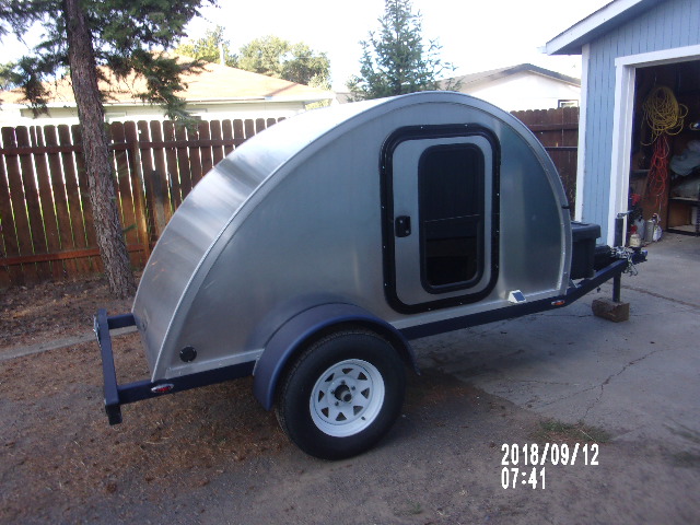

Teardropside (2).JPG (120.77 KiB) Viewed 1368 times
Bought mine with no galley. Don't miss it. My towing car only has a tow rating of 1800 pounds
