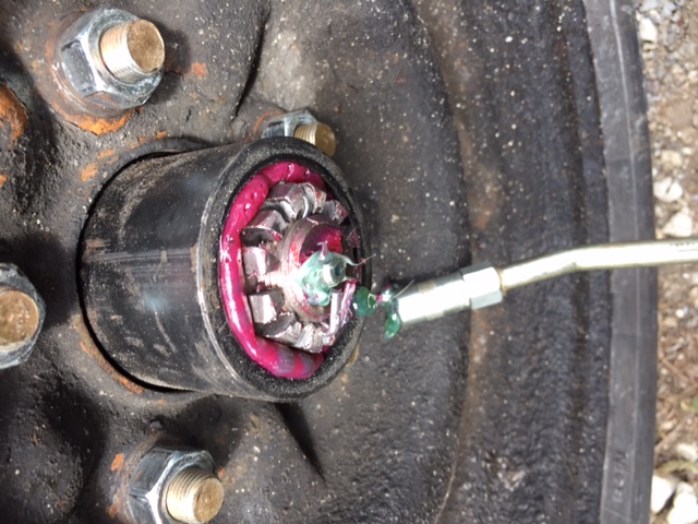

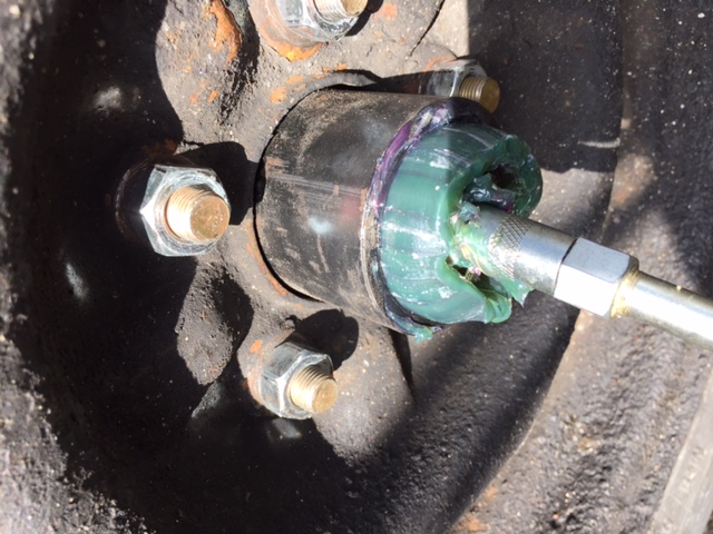

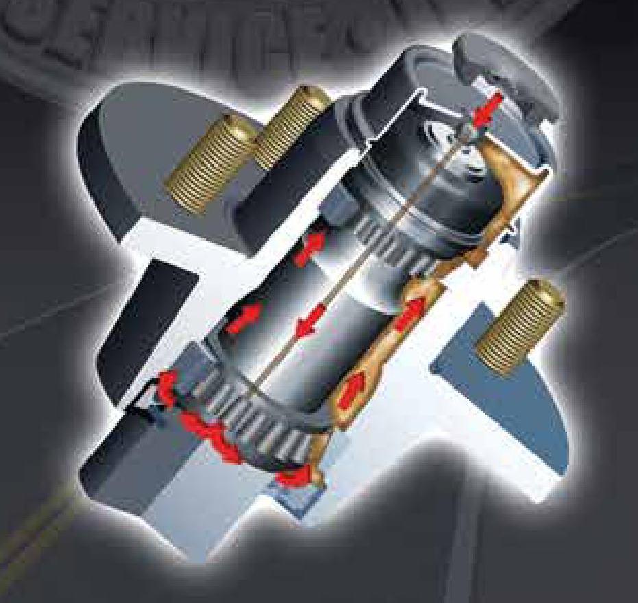

John, the Dexter/EZ-LUBE spindles n hubs can't be over filled w/ grease
their design is such that the grease going in thru the zerk fitting goes all the way past the inner bearing popping into the hub cavity between the bearing and inner grease seal
w/ the tyre off the ground and the wheel spinning gently as you insert new grease thru the zerk the old grease is forced out to the outside of the outer bearing going thru both bearings on the way thru
there is no pressure inside the hub ... it'z just full of grease
bearings that are encased/surrounded with/ grease rarely if ever rust
at the beginning of a season i like to insure the grease is good by forcing enuff grease in thru the zerk that i get nice clean grease coming out around the spindle nut
also i do this to new axles w/ EZ-LUBE spindles so I KNOW what kind of grease is in my hubs
i use marine/boat trailer/off road grease(the blue green stuff) on all my traliers off road toys motorcycles and farm implements
it is considered to be a step above due to it's resistance to dilution by water and even salt water
my latest new axle came w/ these spindles and though "they said" the bearings were greased i changed the stuff that was in there w/ my chosen product
the stock stuff was red and as i pumped new grease thru the zerk the red came out around the spindle nut as i gently spun the wheel
when i got clean blue/green grease coming out i wiped the outer mess away and replaced the cap w/ one that has the rubber insert making future service easier

once this has been dunn annual checking for unfriendly/groweling noises while spinning w/ the tyre off the ground and topping the cavity off at the beginning of the season if no noises are detected is my MO
my last side of the road bearing issue was in the mid 1970's which i attribute to adopting this system ever since
