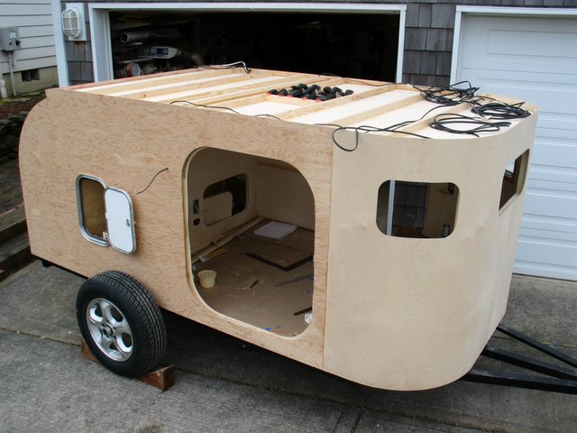

Started building sometime last October. Original plan was to build something similar to Rick Keller's Road Toad, then we saw Camp Inn's new Rain Drop. We loved the Rain Drop's appearance and the possibilities it offered for more windows, so changed plans and decided to do a rip off of the Rain Drop, although with sandwich construction like the Road Toad.
Size is 5' x 10'. Frame is 1/8" x 2" angle, with combination square tube and angle tongue. Axle is Flexride, with same wheels / tires as our Honda CR-V, so no other spare required. Floor is sandwich of 1/4" ply top and bottom with 3/4" Foamular insulation between. Side walls are sandwich of 1/4" ply outside, 1/8" ply inside and 3/4" Foamular. Front is sandwich of 1/8" ply inside and out with 1 1/2" of Foamular between. Roof will be the same, i.e, 1/8" ply x 1 1/2" Foamular x 1/8" ply.
We decided to put a baggage compartment between lower part of galley and cabin (about 10 - 12 cubic feet). It extends across width of trailer for long items like paddles and pop up rain shelter. It's accessable from outside via two baggage doors and from inside by two small doors at foot of cabin.
Lots of lights (all 12 volt) - reading lights, wall sconces and track lighting in main cabin. Plan also to install track lighting in galley area.
Rear end has about 2' radius on top and is vertical on bottom half, as we didn't want to bang our knees while using the counter. Galley has slide outs for stove and cooler, and space for combination microwave / convection oven. Water system will be a 5 gallon jug. Electrical system access will be from galley. Plan not finalized, but propane tank will likely sit on tongue and battery will go behind water jug in the galley.
Just finshed installing inner ceiling skin and most of the roof spars today.
Here are views from outside and inside, if I've done this correctly. More build pictures in the album.

Don....Wow!!!! that really looks great!!! What have you got figured out for the curved window....got a manufactured one in mind or are you going to do lexan? Great job on the build....it appears that your "lurking' time has paid off!! :thumbsup: Doug

Was the curved front hard to do?

I'm impressed. It looks really good. So you did this raindrop format just for the extra windows??? :? You don't have bunks in there for the kids or anything like that?
Gee with all that extra space you could do a mini dinette up front there... or even a bathroom... (okay forget the bathroom, you got too many windows up front there...)
So what are you doing with all that extra space?

Doug,
Plan to install 3/16" or 1/4" plexiglas. According to Cary at Camp Inn, they just bake it for a while and lay it on a form. I found additional information on forming plexigas on the web. Can't remember the details, but I have the directions printed out somewhere. The main idea is laying the plexiglas on a form covered with flannel or other soft cloth and heating it at about 275 - 300°F for about 10 minutes or until it gets soft and bendy. We have some two piece gasket material to lock it into place.
Window areas have two layers of 1/8" ply, so are 1/4" thick plus plan to have .025 or .032 aluminum skin on outside.
Miriam,
The curved front was surprisingly easy. I fretted over it a lot, but the doing turned out to be quite simple. I used 1/8" birch, which will easily bend to a much tighter radius than I used (18"). Did a test fit to find the window position, cut out the windows and then glued and nailed it on with small electric brad gun. Was planning to put on two layers of 1/8", but after the test fit, decided one was sufficient. With the 1 1/2" sandwich construction in front, it is really quite strong. Assume aluminum skin will help prevent punctures from flying rocks.
Mike,
We just thought the Rain Drop style provided more space up front. Thought about all sorts of ways to use it, then decided we could easily put our heads up in that space while sleeping and we could use the extra space between the cabin and galley for storage. The plan is to build the mattress in sections so we can stack a couple sections of mattress in the front alcove to sit on plus a few pillows to lean on and use it for a little reading alcove in inclement weather.
paddlehead

Paddlehead...just my opinion...worked in the sign industry for a lot of years...stick with the lexan...30X more impact resistant than the plex...check out any of the polycarb web sites on specs....the only drawback is that because it has a water molecule in it, it will tend to want to expand and contract with temps, but you don't have a large enough piece for it to really be a problem for your use...and if it is in lexan...I'd be willing to bet that you can just bend it for what you want...lexan/poly can be put in a break and put a 90 degree bend on it, without breaking...plex can't.......either way, sounds like you got it covered... :thumbsup: Doug
