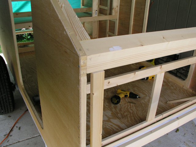

Postby mikeschn » Fri Sep 03, 2004 10:58 am
I didn't plan on doing it this way, but it seems easy enough. I'm building the frames in place on the trailer. Later I plan on gluing up the luan to the frames, and trimming with a laminate router bit.
Then I'll come back and dis-assemble everything and insulate it, skin the inside, polyurethane it, and then do the final glue up... Just like Steve, build everything on the bench!!! :lol:
P.S. Oh yes, here I am gluing up the frames...
