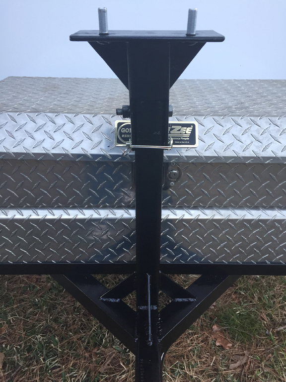

Postby bbrider » Thu Feb 02, 2017 12:36 pm
I borrowed from your idea and made mine somewhat different as I am running full size wheels and tires on mine. Here is a pic without the tire mounted.
