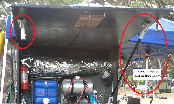

Ok, my hatch door is as simple as they come...a single piece of 3/4" plywood (49.25' tall x 48" wide) attached with three heavy-duty gate hinges. Add two handles (one inside, one out), two hasps, two draw latches, two flagpole brackets used as prop rod mounts, one tin sign ("Made in USA"), weatherstripping, license plate light/bracket, a weather seal for the roof-side, an LED brake/turn/running light combo, and many coats of paint...it adds up to mucho weight.
hatch opened with only one prop rod being used.jpg (107.78 KiB) Viewed 4565 times

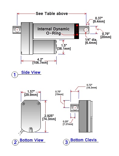

working on it wrote: I've grown tired of using my twin hatch props (awkward to lift, assemble, vice-versa), also because the wife can't do it by herself-unaided-, and on every camp-out, I have to open/close it multiple times. I never could find a telescoping prop rod capable of handling the weight of my hatch (I thought it was only 48 lbs; I was wrong, it's more), or long enough (I open it to 105 degrees, for head clearance). I might use the linear actuator I've found,
18 Stroke 150lb Force Linear Actuator.jpg (38.7 KiB) Viewed 4565 times
to be mounted on an off-center inclined base (on the shelf), between the water jug holder-A/C drainpan and the extended-run fuel tank.
  • I posted measurements, angles, and proposed mounting photos in my gallery,
  • 125498 measurements
  • 125499 where it will go
  • but I never actually weighed the hatch at the 90 degree (horizontal) point, much less the actual "proposed" attachment location for the hatch-side clevis. Today, I weighed it at 90 degrees (couldn't do it at 105 degrees, the pole kept slipping); at the chosen attachment point (9.5" from hinge center, it exerted 120lbs of force). I had anticipated a force over 100 lbs, but wasn't surprised. That's why it's a bear to lift/then hold up, and raise 6" more/then insert prop rods in their holders. I moved the extended-run fuel tank over in its mount 1/2", and now have 2" clearance to mount an actuator and angled ramp.
  • I figure that an 18" stroke/42" overall length/150 lb force actuator will get me in the ballpark. Design angles/bracket mounting spots/hatch clevis-load spreader will have to be tweaked as I go. I used a gas-spring online calculator to check the possibility of using a single gas-spring, instead, but figured it three ways from Sunday, and it showed me that any spring powerful enough to lift it, would be very difficult to compress back to it's closed position. I will also include a quick-detachable pin on the hatch-side clevis (with built-in "wiggle room", to pull the pin), just in case the actuator breaks or the power supply fails. The prop rod system will also remain, as a fail-safe backup.

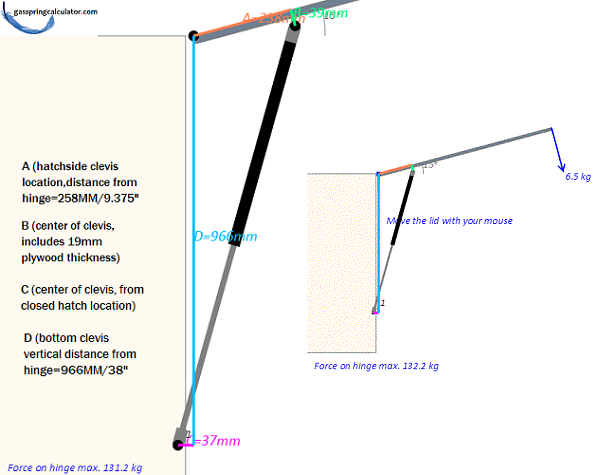

  • You are quite correct, Rob; I seem to have missed some point in the gas spring theory & operation masterclass. I'm relying on computer help, now. I was stuck on using the mid-galley shelf as a spring/actuator/prop rod mounting location, and ignored the obvious conclusion...it was too near the hatch door for proper articulation of a gas spring, and severely restrictive of even an actuator. I agree now, that the gas spring is the way to go (no power failures!), and the "magic" of the self-opening (as Tom described) are enticing. I also thought that the straight up hatch door was a drawback, as all the other examples shown are teardrop "curved" hatches. Then I saw that marine hatches, and flaps, are often opened with gas springs.
  • After entering dimensions into some online calculators, I am getting consistent and repeatable results from them. I have now used three different gas spring calculators, and made actual confirming measurements of the hatch in question (including the exercise you outlined above...my measurements matched your conjectured ones), and find that I have to use a really long gas spring (1002-1328mm, depending on the manufacturer; the example shown in the attachment is a 1028mm spring, measured from clevis eye-to-eye) to do the job. I also found that if I use the suggested spring(s) (if I can find one... the ones suggested by the calculators are sold in Europe!), I will have to create a spring-base space under the shelf to accommodate the long spring.
  • Here's a snip of the computer-generated design:
    gas spring computer designed layout.png (87.37 KiB) Viewed 4263 times
  • If you note the location designated "A", it coincidentally matches the point I chose to mount the actuator clevis, that I calculated by triangulation. Also, the online calculator shows that the hatch requires an initial force of 5.1kg to start the opening curve, then becomes self-opening 11 degrees from closed. Conversely, the initial closing requires 6.5kg force to start down, then progressively more, up to 11.9kg, until the hatch self-closes at that same 11 degrees open location. Sorry about the metrics,,,I've grown tired of converting them back and forth for several days....

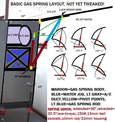

Postby working on it » Sun Oct 26, 2014 10:59 am
  • Went ahead and ordered a pair of gas springs, as I said I would. I'm still not sure if they'll be too strong as a pair or too weak used as a single, so we'll see. I have been researching all the threads on TnTTT for installation hints (there are three running currently) and posted on noseoil's build thread about my wonderment concerning the lack of data on the hatch springs they used (much like very few-proportionately- have weight and balance data to share on their trailers). I know that each home build is unique, no one even follows bought plans exactly, and each trailer (and builder) has quirks. Materials are different from varying sources, and builders have vaying abilities, so none will ever be identical. And when one builds a trailer very dissimilar to the norm, then basically, he's pioneering a new trail(er). As in my case. Of course, many trailbreakers get eaten by the bear around the bend.... Thanks to the people trying to educate me in what must seem a simple? task, attaching a hatch lift, but, as I have stated, I've been so far from the norm for so long on this trailer build of mine, I will always have a series of design quirks to complicate the matter.
  • Noseoil just (kindly) posted a set of detailed instructions to determine the ideal mounting points for the hatch lift, and they are well thought out, and will work great, especially on a curved hatch design. But, I'm already committed to a plan of action, using scale models (dowels cut to length), triangulation, and always allowing for some wiggle room in my measurements (things are often not as advertised; I allow for variations). And I paid my money, I'll take my chances (as paraphrased from Twain, Huxley, et al...)
    basic spring layout scheme 10-26-14.jpg (115.78 KiB) Viewed 4024 times
Last edited by working on it on Sun Aug 12, 2018 11:55 am, edited 1 time in total.

Postby noseoil » Tue Oct 28, 2014 7:58 am
I'm looking at your diagram & it looks good to me. The layout is clear & simple and you did your weight assessment. Like that you actually weighed the hatch at the point you will be using for the pivot, what a novel idea to get it right! It should be better than new once things are installed. Just make sure you use some hefty fasteners, which are well set with T nuts or inserts to take the loading they will have to deal with for mounting. Wood screws or sheet metal screws won't hold up over time on this one.
Curious about the weight of the hatch in the open position at the outer-most edge. If you put a scale under it with a prop resting on it and placed at the "bottom" of the hatch, what is the actual weight compared to the strut location you have selected? tim

Postby working on it » Tue Oct 28, 2014 10:02 pm
noseoil wrote:I'm looking at your diagram & it looks good to me. The layout is clear & simple and you did your weight assessment. Like that you actually weighed the hatch at the point you will be using for the pivot, what a novel idea to get it right! It should be better than new once things are installed. Just make sure you use some hefty fasteners, which are well set with T nuts or inserts to take the loading they will have to deal with for mounting. Wood screws or sheet metal screws won't hold up over time on this one.
  • Everyplace that I drilled thru the 3/4" plywood (sides, roof, floor, and hatch) is sealed with PL adhesive, and I used stainless 1/4"-20 carriage bolts, except for special "security head bolts". I'll use the same on the gas spring mounts. I haven't had any problems with them pulling thru or loosening, since they are glued in place, and have acorns (glued also), nylocks, or double-nuts holding them tight.
  • I don't have the mounting brackets yet, and can't tell from the photos if they will need reinforcing plates or whatever, to hold them firmly on each end. The 3/4" wood shouldn't need backing-up, but I will use some extra metal or wood to spread the force anyway.
  • I never weighed the opened (at 90 degrees) hatch at the outer-most edge, because I knew that wouldn't ever figure in my calculations. But, if I remember correctly, the weight at dead-center was 40-60 lbs (not sure, I was just fabricating a hold-up rod for the accurate measurement at the proposed mtg. point, 9.5-10" from the hinge). I'll make a set of measurements/weights at distance from hinge next weekend. I'm also sure that if I had measured at 4-5" from the hinge, the force would probably double.
