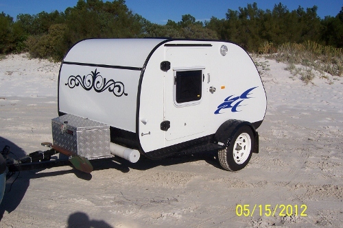

Postby Roo Dog » Fri May 31, 2013 5:54 pm
Paul,
Something different from aluminum.
Steel sign grade colorbond over ply for us.
Prepainted.
SD
