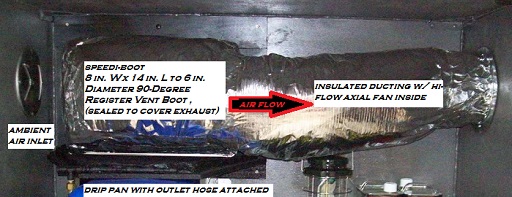

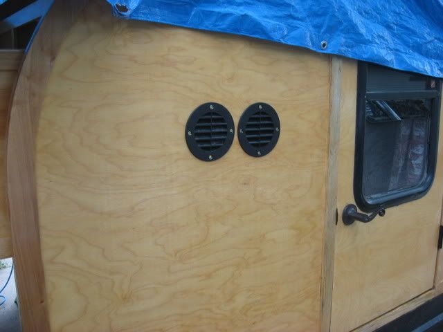

:oops: see I got busy and left out the new pictures. I have holes and vent pipe to the bottom of the TD but also put holes in the outside and in the galley to let Not cold air in.
They problem is you really need to get the hot air out fast. Air Conditioners get really hot :thumbsup:
I also have some bubble insulation along the walls to keep the heat from getting to anything else. I have pictures of this but photo bucket won't up load them right now.
The old way worked but this is better. Now mine is bigger too :lol: 8) Takes more efficient. There are actually 2 pipes going down and a register on the galley side for left intake.
Image cooling.
The left vent is a third exhaust and the other is a intake.

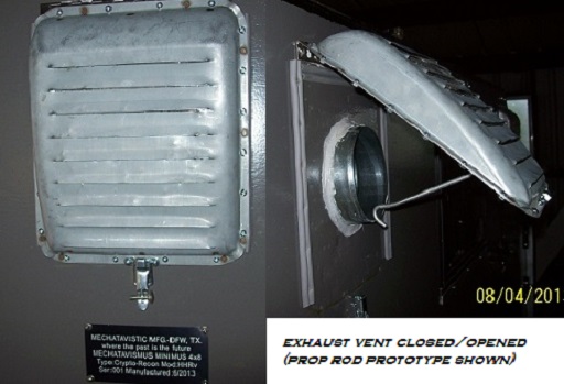

I built mine a bit differently than others, and had quite the experience doing so. Not simple, but that's the way I roll. Here's links to my threads (many more details listed in my gallery): http://www.tnttt.com/viewtopic.php?f=50&t=56667&hilit=exhaust+ducting and http://www.tnttt.com/viewtopic.php?f=21&t=54945&hilit=exhaust I decided on a rear-mounted a/c unit, made to run with the hatch closed, with no action needed to set up (just turn it on); built with sideways ducting and peripheral systems for making it work (vents, duct fans, chassis cooling fan, etc...) due to the short 4x8 trailer, leaving only 20" depth in the rear. I left the ducting exposed for two reasons: I like the look of functional hardware, and I don't need the extra weight a cover would add. Others may want to hide their work. I had problems making it cool properly, because I initially under-estimated the exhaust requirements, but when finally sorted out, it cools perfectly.
airconditioner hi-mounted on rear bulkhead.jpg (108.4 KiB) Viewed 1642 times
rear exhaust plan.jpg (119.91 KiB) Viewed 1642 times
airconditioner exhaust venting outlet.jpg (112.19 KiB) Viewed 1642 times
