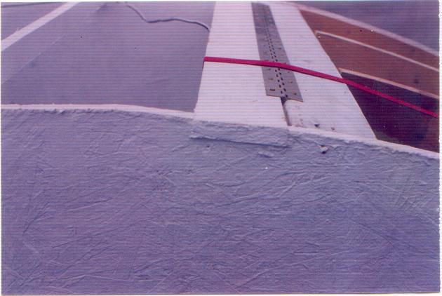

Postby bobhenry » Fri Feb 20, 2015 12:49 pm
This picture is of Eggbert my very first mini build in early 07.
It was last seen setting in the mud behind my foreclosed house last spring.
Despite being abandoned to the elements for years and setting directly on the ground
the white polar seal roof coating protected the osb from the elements completely.
Goes on thick and fills in cracks and voids well. It dries to the touch in about 4 hours
making multiple coats possible in a single day. It does chalk up a bit but it does accept
paint well and made an excellent undercoating.

bobhenry wrote:Image
Looks like some good stuff, Bob! :thumbsup:
