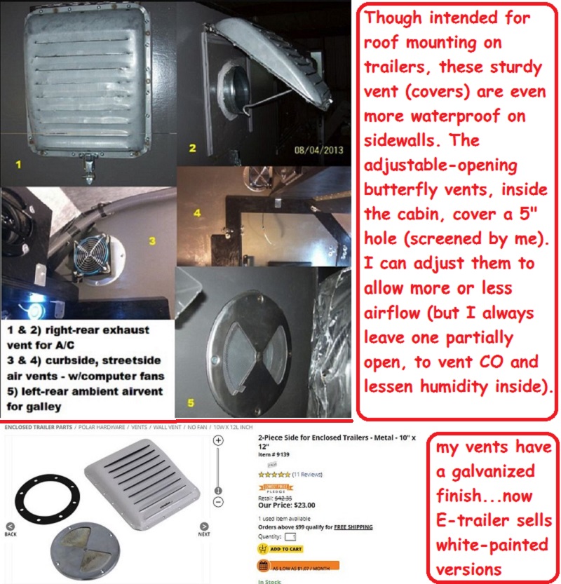

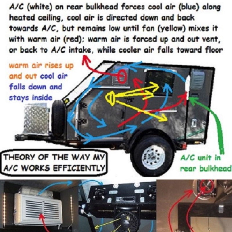

  • I circulate plenty of fresh air, without a roof vent, and without the possibility of leaks or damage to the vent, and with a lower roofline, by mounting sturdy steel vents on the sidewalls. The combination of the steel , waterproof vents (with computer case fans helping airflow) and a strong main fan inside the cabin, provide as much air circulation one mght need, in any weather conditions. The awning-style windows help out, too, when open, even in the rain.
  • I built my TTT for strength, durability, and weather resistance, with no exterior feature vulnerable to the elements. Especially on the roof. I've been in trailers that had roof leaks: from either the overhead A/C unit, a torn rubber roof, or (most frequently) from a roof vent; that ruined the interior. I just recently had to replace the damaged/deteriorated plastic cover on my 20ft trailer's vent (which had cracked, and was leaking), before I stayed in it, while my new house project was underway. It was replaced before any water damage had occurred (soaked up by the wool vent insulator, and didn't get past it), fortunately, but it reinforced my view that overhead vents were prone to damage & leaks, over time.
  • I wanted waterproof vents, preferably not installed in a vulnerable spot (less chance for damage? tree limbs, hail, meteorites?), like the roof, and made of steel, not plastic.. Having run a shipping/receiving dock for years, I saw enclosed trailers with all types of venting, and wanted to emulate that in my build (also an automotive-type piece, which I was leaning towards as a sub-motif). I narrowed the choice down to two "enclosed trailer vents", normally roof-mounted, but would serve even better mounted on the sides. Here's a comparison of the two "finalists" I chose between: http://www.etrailer.com/comparison.aspx?pc=RV-626-062&pc2=9139 Primary usages are to admit insect-free ambient air, and expel humid stale air. Computer case fans are mounted behind them, to make them more efficient, at a low power cost. The vents were to be sealable, waterproof, screened, and rust-resistant. I chose the Redline 9139 (also partly because it looks like a drive-in speaker!- liked the retro look), and it has a butterfly closure for tunability.
  • In hot weather, the interior is cooled by A/C, in moderate weather by a 11" fan (and two awning-style windows), and in cold weather, by one or two 200 watt heaters. Small computer case fans circulate minimal airflow thru the upper wall vents at all times, reducing humidity build-up inside. A high-flow fan (a Honeywell 11", under the front overhead shelf) uses variable fan speeds and angles to circulate the interior air.http://www.tnttt.com/viewtopic.php?f=42&t=69753
