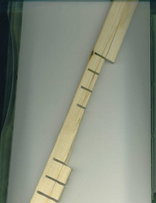

I am resurrecting this because I tried today to get it to work and had a problem.
I made a sled to hold my wood and put a sacrifice board to back the cut piece. The problem I had with the 1x2 (3/4) is that halfway up the teeth kept breaking off during and after they were sawed. I am not sure if it is because the cheap wood. :roll: or the thickness. I was cutting every inch and the sled worked great but the pieces fell off anyway.

I am assuming you are using a sled on a tablesaw. Are you pulling the sled back thru the blade after making the cut? If yes, remove the cut piece before pulling the sled back through. If that isn't the cause, maybe the grain pattern in the wood. All that kerfing is the reason I decided to cut the curves instead of kerfing.

Auntie M, are you saying the wood kept breaking off...if so your cut was too deep or you were cutting with the grain instead of against it...I hope you didn't mean the saw teeth were breaking off :shock:

MJ The kerfed peices were breaking off dead center.
I think I have enough time and little experience so the kerfing (if I can get it right) will be easier for me.
Yes I was pulling it back through :oops:
I was also using a ripping blade. Bother in law says use a plywood blade. :oops:
:oops: Way too deep for the blade width.

A M...sounds as if you are cutting to deep...the blade type really doesn't make a diff here neither should pulling back thru, it can only cut as deep as your adjustments allow...try a shallower cut, leaving AT LEAST an 1/8th" or better....if kerfing ply, try leaving at least some of the SECOND ply and if cutting solid wood, make sure you are cutting across the grain and not with it...

You may be right. I put this on the scanner and the wood may be destined to splint there too. The light shows a crack that isn't real visible with the eyes.

Looks like that 1st cut (with the knot on the outer edge) would have failed when you tried to do the bend. It would have broken right there. Looks to me like the grain was the main culprit.

ahhhh haaaa, now I see (said the blind man)...the crack in your board is the main culprit here(that is why we luv da pics)...to be succesful in what your doing you will need wood with a good clear grain...and whtch out for those knots...the one in question(on the edge above a kerf) could cause a failure at that point...
