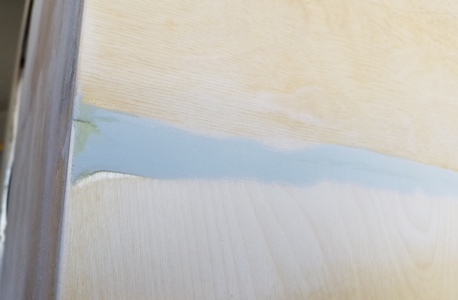

Postby twisted lines » Sun May 03, 2020 3:49 pm
Thanks for taking the time to share Swoddy!
I will use a little of that Technic resealing, after a little touch up with 60 grit :thumbsup:
First & only caulk going in the front seam under the Radi.
It also blends from 1/4" to 1/8"; This layer was sealed and cured for a few months before sanding.
I am wondering if I will know what it looks like in 10 year's,
Just like my time with boats; but I only want 1 more ft.
I certainly never built a wooden one! :beer:
.250-.125 Feather.jpg (39.27 KiB) Viewed 2649 times
Last edited by twisted lines on Sun May 03, 2020 9:38 pm, edited 2 times in total.
