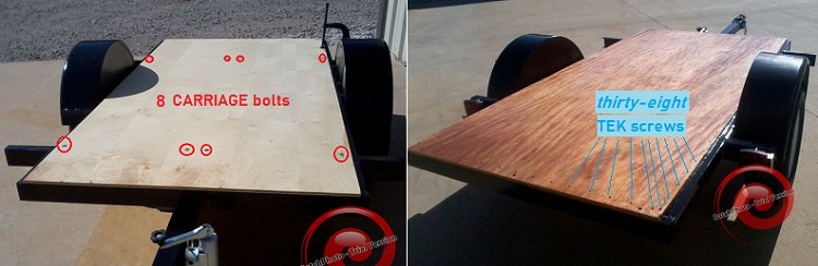

* I used eight 3/8" carriage bolts thru 1/2" birch plywood, thru two angle steel crossmembers, as the base for the floor. I semi-countersunk them (crushing the heads into the plywood) so they wouldn't make visible bumps when I overlaid the birch ply with 1/4" luan-faced ply (using TB2 to glue the plys together).
* After the glue dried a week (compressed with a hand-roller, then with weight applied on top), I used thirty-eight TEK screws thru both sheets of ply, into the perimeter frame of 11 gauge rectangular steel tube.

173193172890148599
