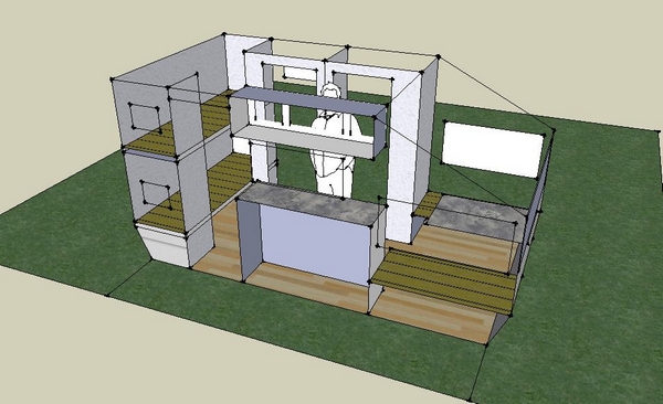

Postby Gerald_G » Sun Jul 23, 2006 9:25 pm
I am working (slowly) on a project of a bigger size.
Here's a sketch of what I hope to end up with....
There is no plan, (except in my head), yet, but I am working on some cad drawings for my sidewall layouts. Of course the windows sizes are for my specific recycled windows, etc.
You can follow my progress in the following thread.
http://tnttt.com/viewtopic.php?t=9017
