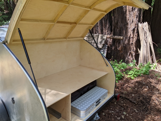

Short version of the question: does anyone have good ideas for modular tie-down systems in the galley? L-track seems almost ideal, but is a bit expensive and overkill (in terms of load rating) for what I need.
Longer version: I intentionally made teardrop galley is about as simple as can be: a countertop with storage space underneath. I wanted maximum flexibility and volume for bringing various sizes of coolers, stoves, propane, etc. Now, I'm looking for modular tie-down systems for both above and below the counter area. I like E-track and L-track, but E-track is a bit too large and both seem to be a bit overkill for what I'm trying to do here. I'd love to have several rails for maximum versatility. The lo-fi version would just be to screw D-rings every 6-12", but I like the track systems a bit better.

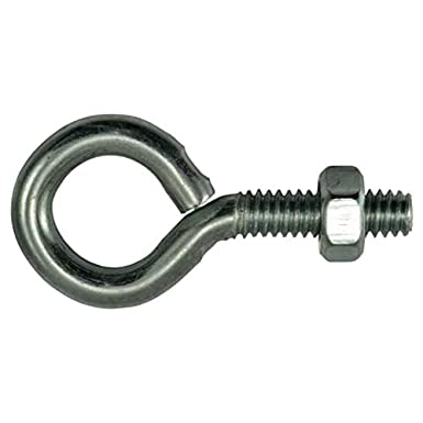

i use a hold down system in the floors of my trailers that have a threaded insert bolted into the floor that has a threaded hole thru the center called BED BOLTS
they are for 3/8" forger eye bolts which can be fingered in place and back out as desired
here is a similar system concept using 1/4" eye bolts
drill a hole in your surfaces and install the screwed in place t-nuts from underneath
the surface remains flat and unobstructed when the eye bolts are fingered out and where the holes are under an object you are holding down
