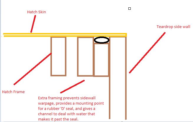

I do it like this.
Since I built with just single pieces of plywood for the side walls, not composite skin on frame like Tony, the curve at the back, where the galley opening is, needed some framing to prevent warping. I built that framing with a groove in it to accept a D seal.
Hatch seal.JPG (35.22 KiB) Viewed 423 times
