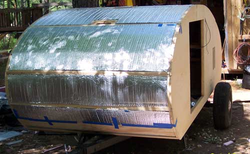

Laredo wrote:Reflectix insulation.
This looks interesting, and it comes in 6' widths.
http://www.insulationsolutions.com/prod ... ation.html
Postby Sonetpro » Tue Aug 08, 2006 4:55 am
It seems to work. I can stay on the beach all day and the tear stays pretty cool.
