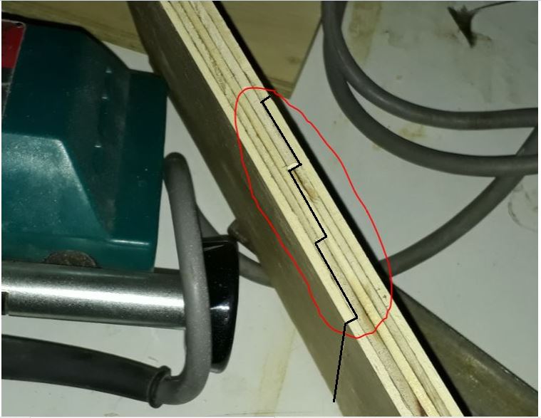

Postby MickinOz » Tue Dec 24, 2019 5:33 pm
I've fiddled with the photo in MS paint to show the approximate glue line.
The glued panel is 6 inches wide (~150mm)
I laid it over the edge of the bench this morning and couldn't flex the joint putting my (not inconsiderable :( ) upper body weight into it.
Since there has been no commentary saying this is a really bad technique, I think this is how my 17mm (11/16) wall panels will be extended.

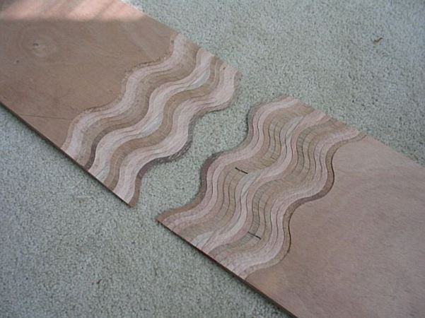

I searched a little after you did your's, and found this and may try this self aligning trick next time :FNP

Good Lawd. How the heck do they cut that?

MickinOz wrote:Good Lawd. How the heck do they cut that?
Push a button :lol:
