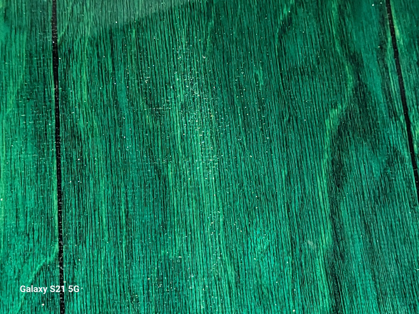

Below an example of the shimmering shards I'm mentioning. The sharda are viaiblw on the left hand side, but not visible on the right.
Are these shimmers normal? They arent present in 100% of the cloth, and I'm trying to reduce the frequency they occur.
I'm trying to avoid them, for aesthetics purposes

The photo you show doesn't look bad. Close inspection, especially at certain light angles, might show some hint of weave. From a few feet away it shouldn't be noticable.
I was thinking you had cloudy, white patches. I bought a mahogany sailboat like that once, ended up just painting it.
