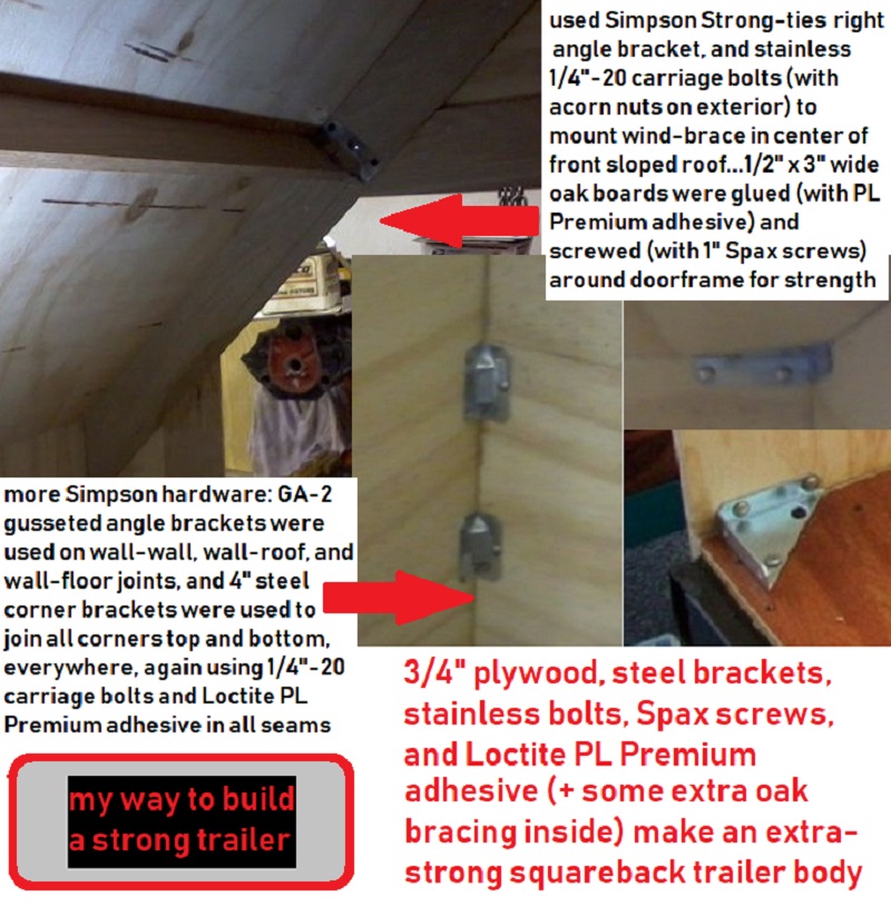

* Mine is 4x8, 3/4" plywood floors/walls/roof, etc. Using zero spars, just Simpson StrongTies angle brackets, and generic steel corner braces from Home Depot and/or Lowes. Plus 10-12 tubes of Loctite PL adhesive. I did use additional 1/2" thick 3" or 4" wide oak boards as inner bracing around my doors, windows, and the interior-mounted A/C (in the rear bulkhead). The roof overlaps the sidewalls and front & rear bulkheads, attached with the aforementioned hardware, using 1/4"-20 stainless carriage bolts, fender washers, and either acorn or nylock nuts, with PL adhesive at every interface, and seamed inside and out with the same. No leaks, no runs, no errors! Every hole drilled was filled with PL, and the entire exterior was coated with the "mix" of polyurethane and thinner (3 coats), then with oil-based Acrylic silo or farm implement paint (two coats).
* After 9 years, there has been no separation, delamination, nor warpage. The roof is as flat as ever, since I clculated that there would be sufficient strength just using 3/4" plywood and the brackets, without spars. I used this http://www.woodbin.com/calcs/sagulator/ to calculate the strength, and or possible warpage (3/8" wasn't strong enough for mine.
* I have no build journal, but my postings and gallery photos tell my story, so if you can glean any info that might help your build, then you're welcome. Good luck.

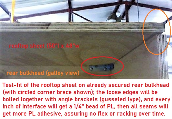

* You do understand that the main weight of the roof sheets (mine is 50"x48", the "front slope" sheet is separate) rests atop the top edges of the sidewalls (extending from the "front slope" sheet above the doors, to the open rear (where the hatch door hangs from the rooftop sheet) with the angle and corner braces mainly used as attaching plates. The vertical rear bulkhead is 22" from the rear, and it supports the major portion of the rooftop sheet's weight.
here's how it was bolted & glued together
steel braces, bolts, and PL.jpg (247.44 KiB) Viewed 1700 times
roof sheet laying on top, unattached.JPG (137.63 KiB) Viewed 1700 times

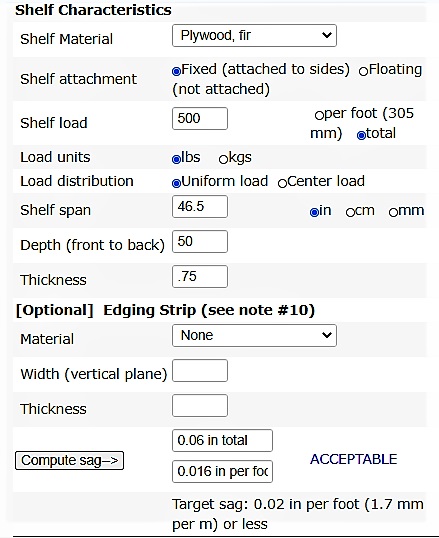

* I used the Sagulator calculator https://woodbin.com/calcs/sagulator/ to verify whether my 3/4" roof would resist sagging without support beams underneath. it said it was acceptable. 1/2" or 3/8" plywood wasn't. I have tested it by standing on top a couple of times (always pushing the envelope...at 230 lbs), and no sag was felt. I put a straight edge on top each year, just to check, and it's still flat. Here's my calculation sheet:
roof weight-bearing calculation.jpg (87.15 KiB) Viewed 1700 times
