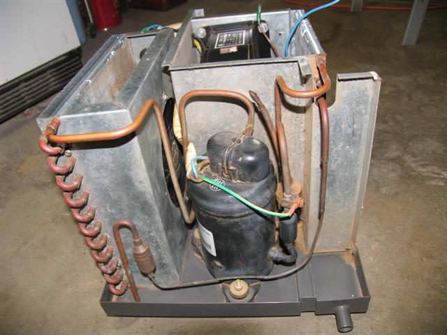

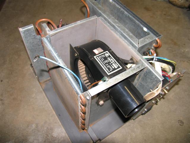

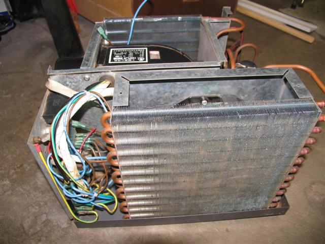

Here's some pics of the inner guts of a Pet Cool if anyone is curious about what's in there. The wires hanging loose on top go to the 300W heater that I was fixing at the time of the photo.

Thanks for the pics Bruce! I was wondering what the guts of a petcool looked like.
So it has separate fans for the condenser and evaporator?
I don't see why you can't make it a split unit. All you would need to do is extend the charge lines.
If I build another trailer, I want to experiment with making a split unit.
