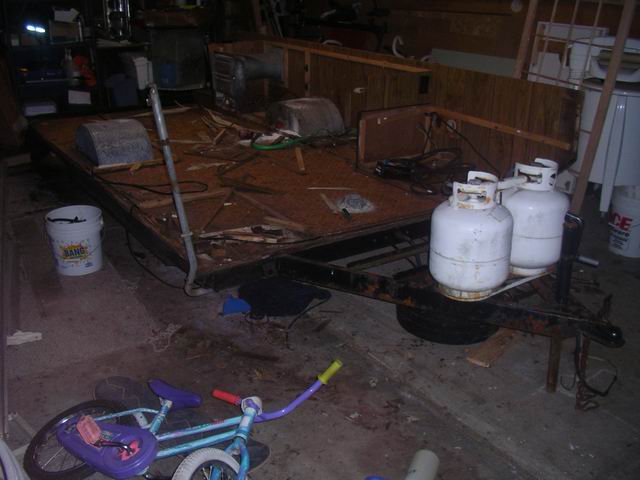

I've been looking forward to joining the ranks of those actually building for a long time- This past weekend found me buying a very ratty old pop-up camper for $100 bucks. While being quite soggy, the frame looks good and solid, and once there's new tires and bearings, some surface rust removal and some fresh paint it'll make a great base for my planned new travel trailer. The frame measures 80 inches wide, by 11 feet long, which is exactly the size of Aliner's Cabin-A. Not a tear by any means, but functional, so my design will be "inspired" by that type. Why completely rethink the wheel, I guess. I need space for sleeping 2 adults and two kids, and I'd also like to haul our tandem bike inside, so that'll fit the bill. My original plan was to build a Glen-L Sequoia, but that's fallen by the wayside with the purchase of this. I've spent a few hours "deconstructing" the trailer, it looks like I got a good 3 burner stovetop, a good water tank, faucet, and a bunch of assorted moldings as well as the trailer proper. Sorry about the dim pic, it gets dark early here in Milwaukee

That Cabin-A layout should suit you. Take the table out and you've got space for the tandem down the centre. One suggestion: how about longitudinal bunks for the kids - this means that they can be separate (or do you have the no-fighting type of kids?) and there's space for someone on the queen-sized dinette berth to get out if they want to.
