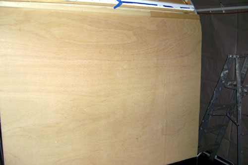

NightCap wrote:Yep, I was using an air brad nailer with 18 guage brads on Luan. You all made me feel better about things. I am going to try using that 1/8th inch between deal. Oh, and reducing the pressure on my compressor. I think that would have helped. And I am going to epoxy it quite a bit. Is it unreasonable to want my tear to out last me?Oh, and thanks for the hugs and stuff.
Here is a pic of the panel after I pulled the spars off. I guess it turned out ok, (amazingly) This view doesn't show to many inperfection but I will have to epoxy the snot out of the edges..Right Mike? And thanks for putting things into perspective Tripmaker
You have the intestinal fortitude I need.
I left the top tack strip on till morning. Just in case.
NightCap wrote:I think she meant that if the heads of the brads sink in 1/8 inch, then if you use a piece of 1/8 luan and brad through it the brads might be flush on the luan underneath. Right guys?
Tripmaker wrote:Hey NightCap,
If I had wood like that I would want to show it off too.That stuff looks nice, where did you find it? I've seen nice stuff in 4' but not in 5'. I thought mine looked good but I've got the football repairs. I don't even see one football your's.
