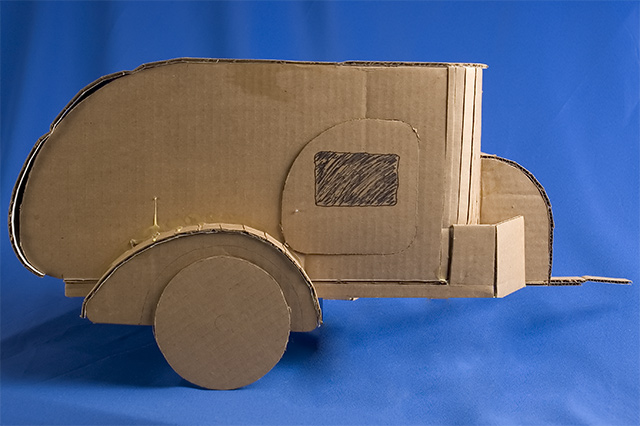

Design Review - 4 x 8ft - Round Nose
Postby WarPony » Tue Nov 07, 2006 10:10 pm
ballpark wrote:And maybe the 5ft would be a better idea...
Dude, make it 5 wide and keep the hatch just like you "drew" it. I really like that design........ the curved front that Cary has is SO choice!! If not anything, make it 5 wide. You won't be as sorry for spending the extra money to make it that wide as you might be for NOT spending it.
If you want to see what I mean, take some cardboard and measure out 4 feet and then both of you lay inside the walls. Now, move it out to 5 feet and see how much it really opens up.
I'm not trying to tell you how to build your tear but I've seen how some people have been sorry they didn't go wider.
Let me know if I've overstepped my boundries :worship: .
WarPony
Posts: 2089
Images: 289
Location: Kansas, Topeka

Postby ballpark » Wed Nov 08, 2006 10:23 am
Thanks for the information everyone.
5ft sounds like a good idea.
Mike, Kurt,
I will send you the files tonight. (probally late)
I am starting to think a custom fabricated frame may be a better bet. I would say 9 x 5 x 4ft (height) Its funny how this small trailer keeps on getting larger. Lightweight is still the goal. And as always "Keep it Simple Stupid", is my motto.
